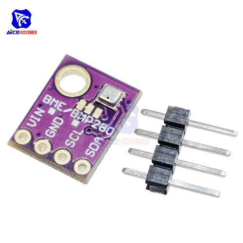

Please, post the picture (both sides) of your BME280 Module.
Here is the link of the module I've purchased, hope you can view it
(I've to use older library version only on Nano EVERY, was working fine with last library version on UNO R3)

The new Adafruit BME280 library requires the Adafruit unified sensor library as well, the BME_280 library alone won't work. Include both libraries and see if that helps.
