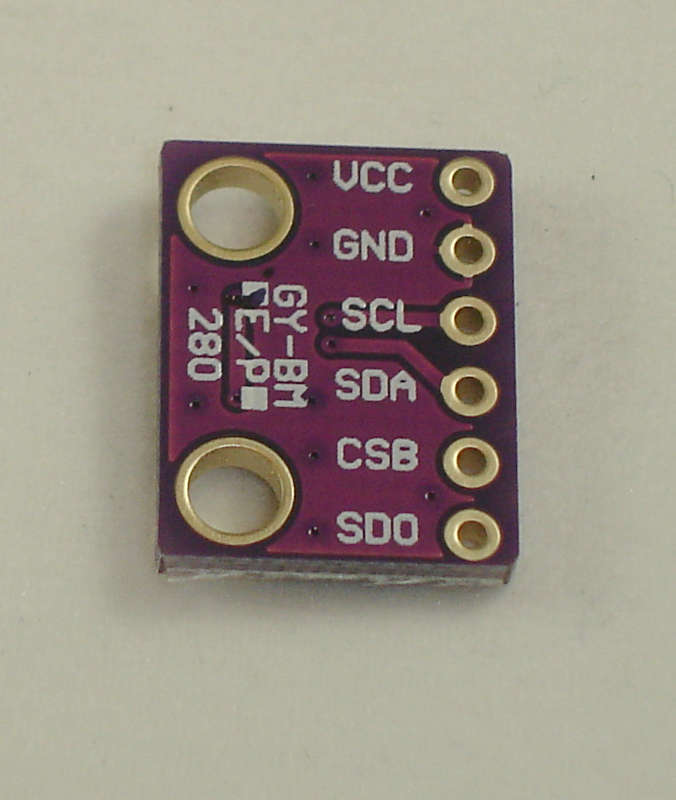

Hello,
I connected a BME280 module to Arduino UNO, VCC = 3.3V, SDA to A4, SCL to A5 (without any logic level conversion)
The scan of I2C for BME280 is correct,
"I2C scanner Found address: 118 (0x76)"
But the sketch gives error
"Could not find a valid BME280 sensor, check wiring!"
I use "cactus_io_BME280_I2C" library
What am I doing wrong?
zoomx
2
Maybe the library uses another I2C address. Check library.
Hello,
The seller says
Specifications:
Supply Voltage: 1.8 - 5V DC
I connected the module to 5V. I tried with two libraries, and it did not work.
Then I have seen that the module is for 3.3V. I thought it probably burned.
The seller sent me a sketch, which works without any library, and my module works perfectly! Miracles of the solid state

zoomx
4
If I remeber right Adafruit library use 0x77 as address but you can change it in the library or maybe use a begin(0x76).
