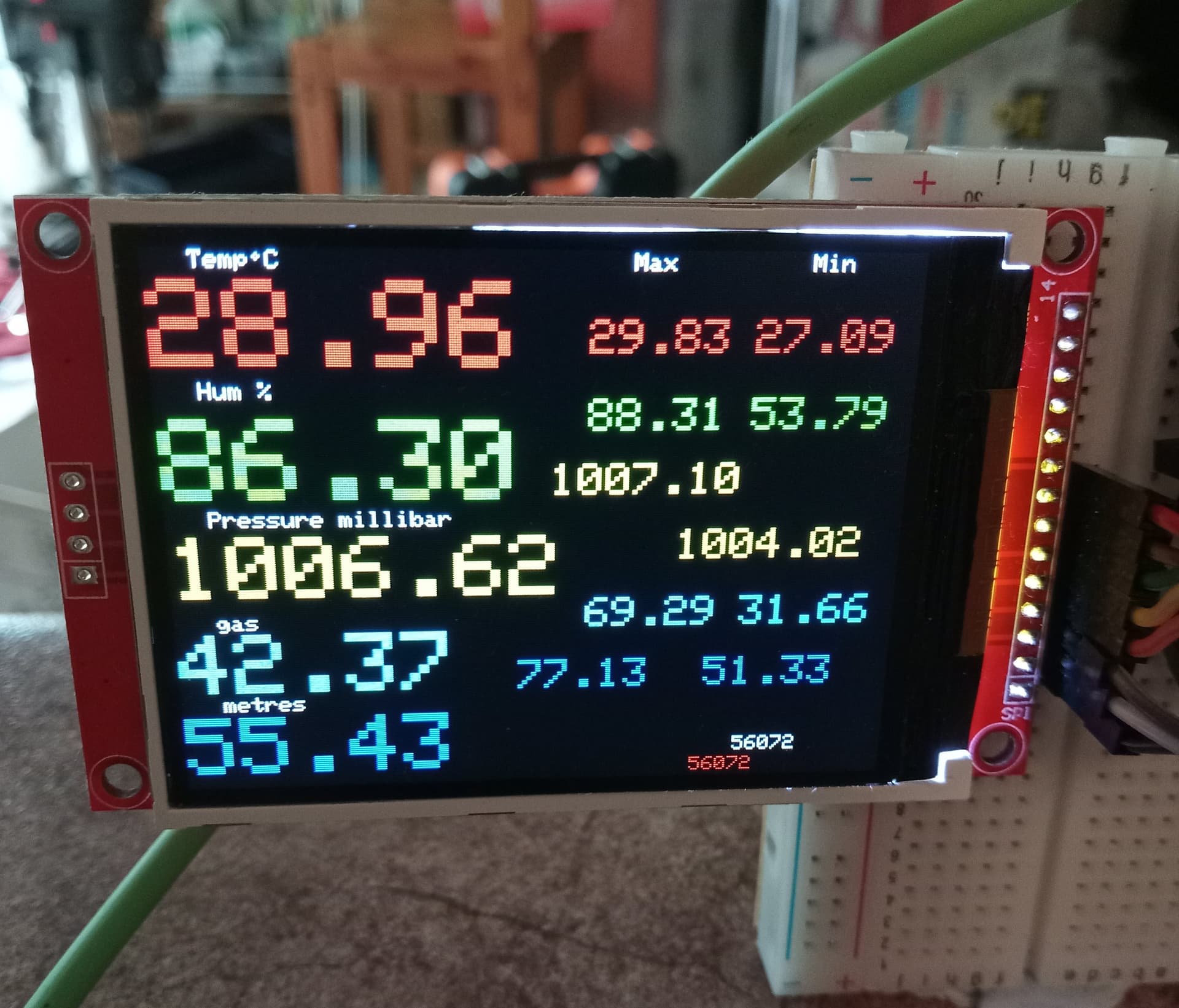

BME680 temperature sensor with ESP32 & 2.8" TFT Display
Connect BME680 temperature module to ESP32 Dev Kit and display on 2.8" TFT ST7789 Colour LCD Display.
To measure temperature, barometric pressure, elevation in metres above sea level, volatile gases and relative humidity in metric. With minimum and maximum for each quantity for a roughly 24 hour period. Plus small red counter in seconds. Updates every 16 seconds.
minMaxEsp32BME68022ST7789.ino (6.7 KB)
Should be fairly easy to adapt to Arduino. Connect BME680's SCL and SDA to pins A4 and A5 on Arduino, which are pins 21 and 22 on ESP32 (not in any order there). You'll need something like a level converter for the 5V Arduino if driving a 3.3V display.

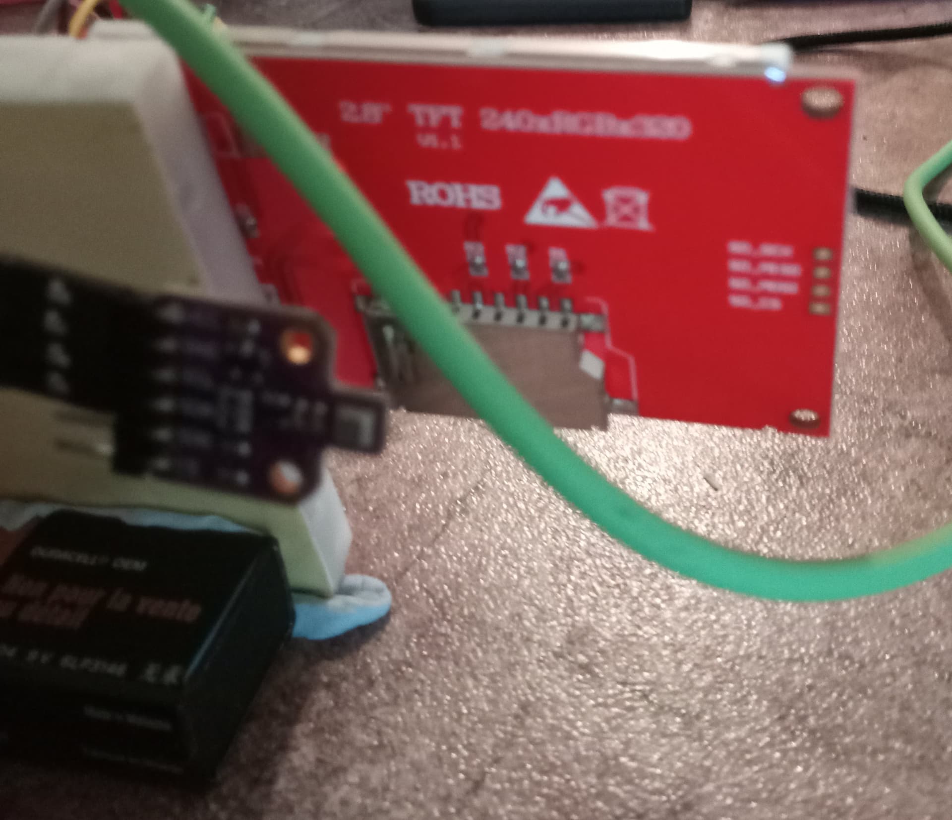

// 2.8" TFT ST7789 display ==> ESP32 Dev Kit.  All pins are on one side of ESP32 board.
#define TFT_SCK    18
#define TFT_MOSI   23
#define TFT_MISO   19
#define TFT_CS     4
#define TFT_DC     16
#define TFT_RESET  17
//  BME680  to ESP32 pins:
//  SDA ==> 21
//  SCL ==> 22
  Arduino_ESP32SPI bus = Arduino_ESP32SPI(TFT_DC, TFT_CS, TFT_SCK, TFT_MOSI, TFT_MISO);
  Arduino_ST7789 display = Arduino_ST7789(&bus, TFT_RESET);

I improved the min max by making the numbers much larger. And took the equals sign out of the min max comparison to speed it up a bit. And added a line to include seconds since last min/max, bottom right in white.
i updated the .ino without changing the file name:
minMaxEsp32BME68022ST7789.ino (6.8 KB)

  Serial.println(F(" *C"));
  Serial.print(F("Pressure = "));
  Serial.print(bme.pressure / 100.0);
  Serial.println(F(" hPa"));
  Serial.print(F("Humidity = "));
  Serial.print(bme.humidity);
  Serial.println(F(" %"));
  Serial.print(F("Gas = "));
  Serial.print(bme.gas_resistance / 1000.0);
  Serial.println(F(" KOhms"));
  Serial.print(F("Approx. Altitude = "));
  Serial.print(bme.readAltitude(SEALEVELPRESSURE_HPA));
  Serial.println(F(" m"));
  Serial.println();
  display.fillScreen(BLACK);
    display.setCursor(250, 220);
  display.setTextColor(WHITE);
  display.setTextSize(1);
  display.println((timenow-lastday)/1000);
  display.setCursor(198, 1);
  display.print("Max");
  display.setCursor(272, 1);
  display.print("Min");
  display.setCursor(180, 27);
  display.setTextSize(2);
  display.setTextColor(RED);
  display.print(maxtemp);
    display.setCursor(250, 27);
  display.print(mintemp);
    display.setCursor(180, 60);
  display.setTextColor(GREEN);
  display.print(maxhum);
    display.setCursor(250, 60);
  display.print(minhum);
  display.setCursor(20, 1);
  display.print("Temp");
  display.drawCircle(46, 3, 1, WHITE);
  display.setCursor(50, 1);
  display.print("C");
    display.setCursor(2, 12);
  display.setTextSize(5);
  display.print(temperatureC);
  display.setCursor(20, 54);
  display.print("Hum %");
            display.setCursor(2, 69);
  display.println(hum);
          display.setCursor(2, 120);
  display.setTextSize(4);
  display.setTextColor(YELLOW);
  display.println(press);
  display.setCursor(20, 109);
  display.println("Pressure millibar");
      display.setCursor(164, 88);
  display.print(maxpress);
    display.setCursor(220, 118);
  display.print(minpress);
              display.setCursor(20, 156);
  display.println ("gas");
              display.setCursor(2, 165);
  display.setTextColor(0x067F);
  display.println (gas);
        display.setCursor(180, 150);
  display.print(maxgas);
    display.setCursor(250, 150);
  display.print(mingas);
  display.setCursor(20, 195);
  display.println("metres");
  display.setCursor(2, 205);
  display.setTextColor(BLUE);
  display.println(m);
          display.setCursor(150, 180);
  display.print(maxm);
    display.setCursor(235, 180);
  display.print(minm);
  display.setCursor(230, 230);
  display.println(time);
  delay(16000);
