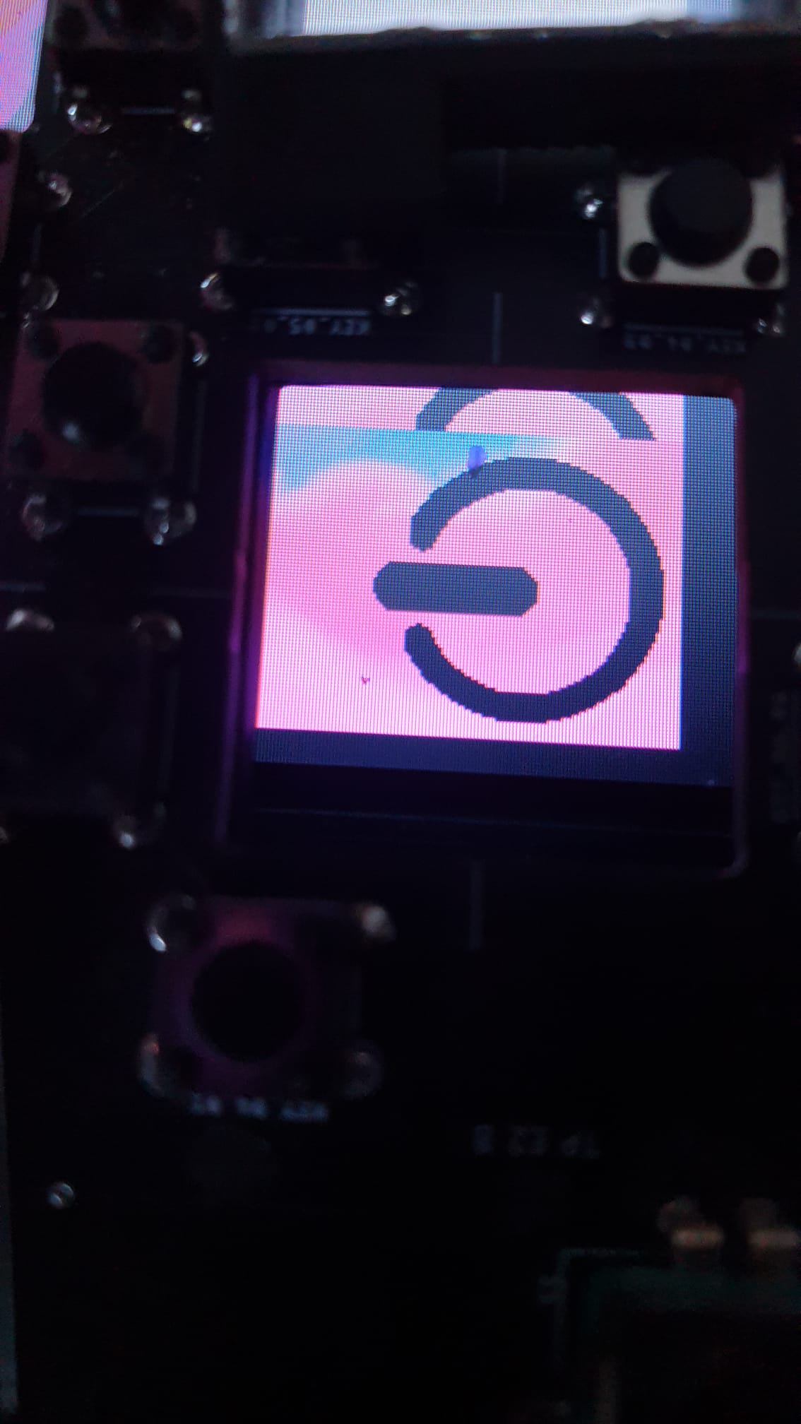

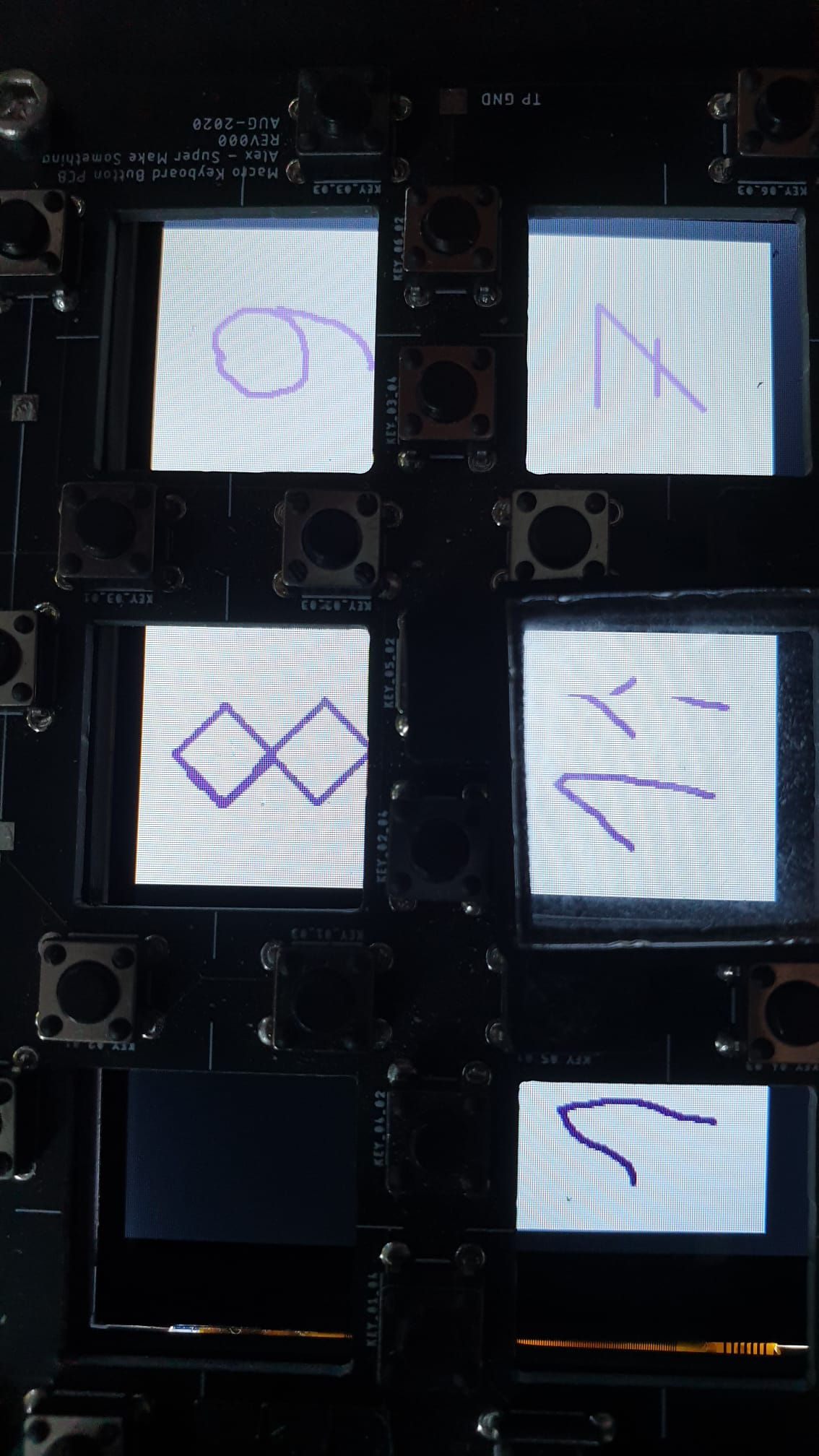

I programmed an Arduino Nano to display bmp images on a lcd tft display.
The code I wrote is doing some other stuff too but that is not imporant the only thing thats not working is the displaying of the bmp images. If you have any questions about my code feel free to ask.

What was expected, and what was actual.

Thank you for all those answers I dont think. that the problem is related, to the files on the sd card because the following code works fine with drawing the BMP images but it has some other problems. Do you have any other ideas or should I just try to instead searching for the problem in the other code just copy the draw funcion from this code that works just fine with drawing the images?

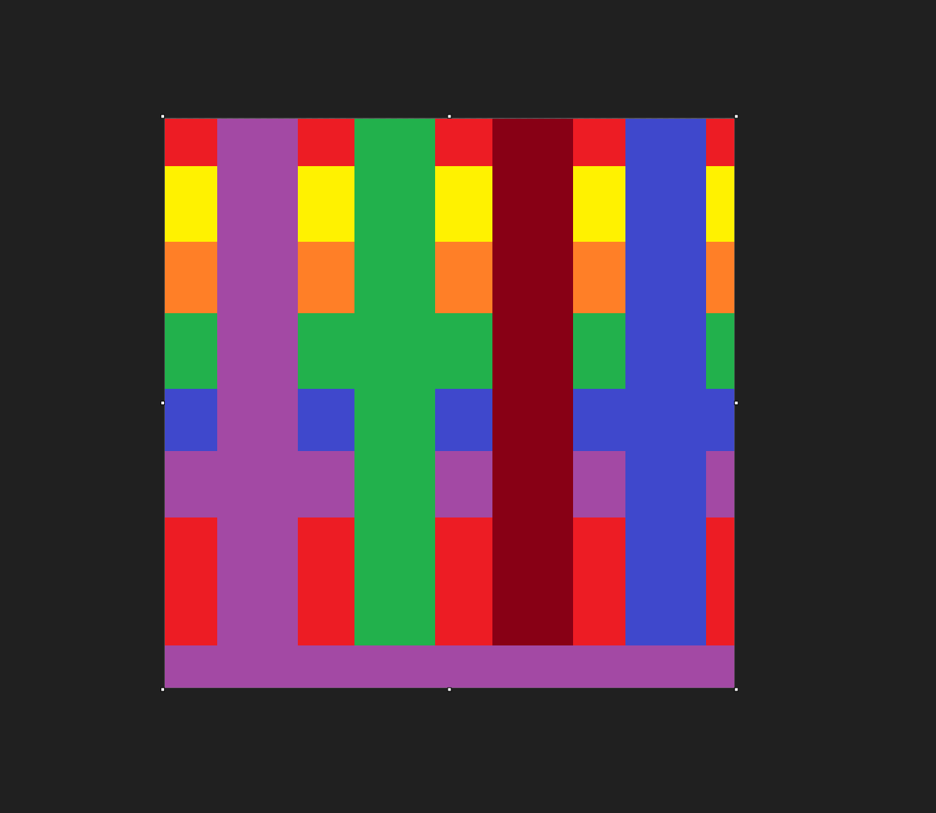

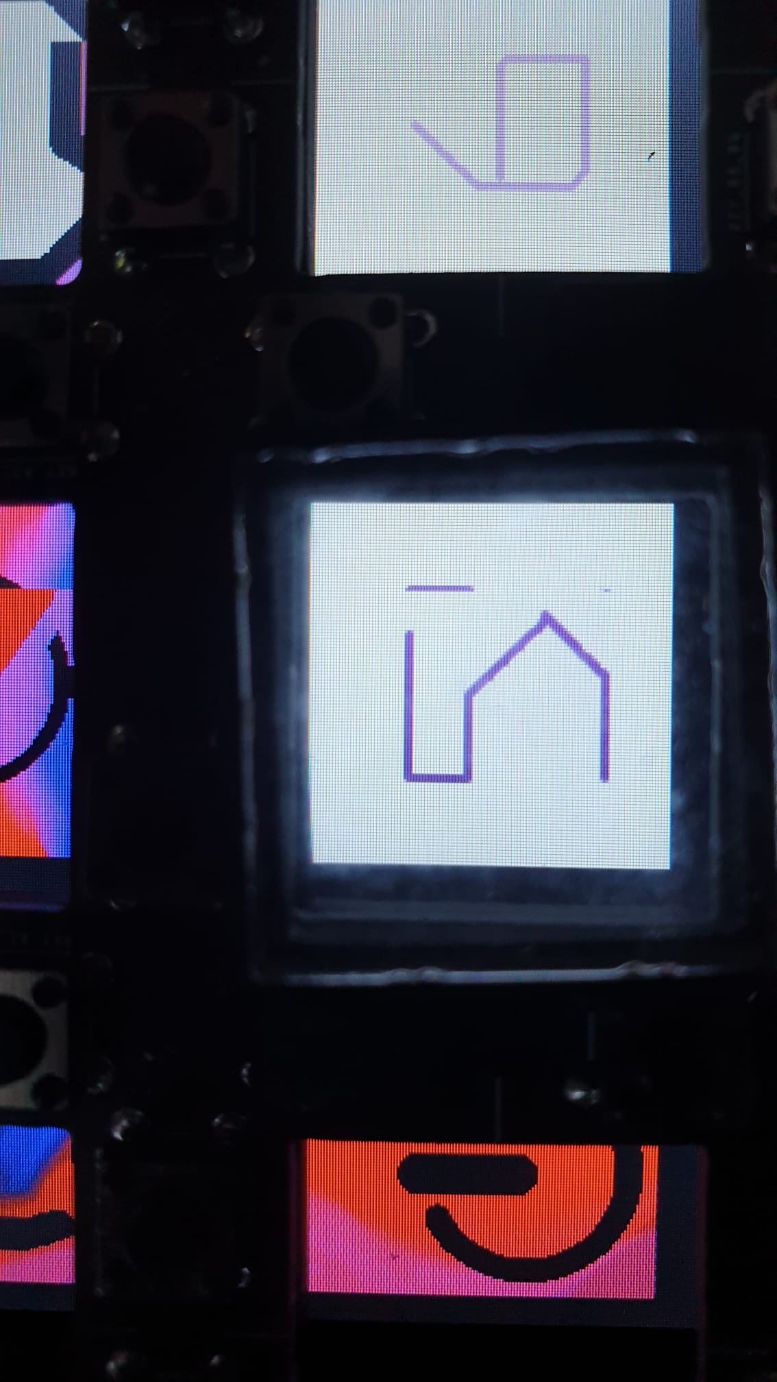

Here a image that should be more clear on what is acually happening with the bmps
    int pos = dataOffset + (bmpHeight - 1 - row) * rowSize;
With a 120x120 pixel image, and an offset of 54, which gives a rowSize of 360, the equation produces an answer of 43254, which will not fit in an int. Change pos to int32_t.
