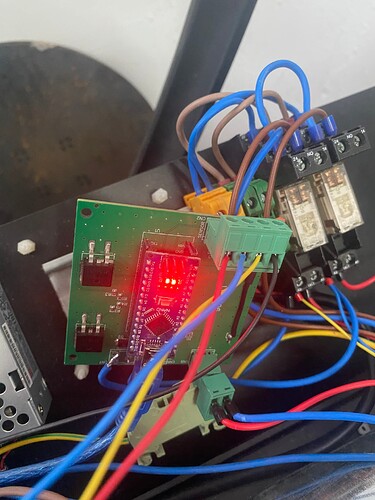

I have the breakout board. So only connections are 3.3V of Arduino, SCL, SDA and GND.
Here are some photos:
The soldering here looks sketchy
The other side looks a little better, but I still doubt it's a solid contact. Have you checked whether wiggling the sensor makes it lock up even more easily?
How does this relay section relate to your circuit:
What drives them and when, and have you tested just the Arduino + sensor board and nothing else connected in any way, powered from computer USB?
Can you post a schematic of the whole setup?

The I2C bus was designed for ICs mounted on a single PCB to communicate.
Connections longer than a few cm cannot be expected to work without difficulty or at all, although for problematic longer connections, there are some things to try, like lowering the value of the pullup resistors on the SDA and SCL.
You must use a bidirectional logic level converter when connecting 5V MCU and 3.3V sensors, unless the sensor module has those built in. I doubt yours does.
I tried wiggling the sensor but it works alright when it is working.
The relay circuit is irrelevant because the sensor gives the same error when there is only an arduino and the sensor.
I have tried different libraries and checked the libraries and also the datasheet. They correspond.
I think the real problem is because of how I use the sensor. I directly blow at it. So the fluids in my mouth could pile up after a while. That could affect the sensor.
I think you might be right as well but it doesn't contribute to the problem as I thought it would. The connections I made at first were a few centimeters long but now it is actually about a meter.
I do not use a level converter. I don't know how I missed that. However, I still think that my problem is not about all that. As I explained it to rsmls, the reason could result from how I use it.
I see what you mean, but I don't think that's it, honestly. This wouldn't lock up the controller. The lockups suggest a power supply problem, or some exception on the I2C bus from which the ESP doesn't recover - although I find that already quite far-fetched.
