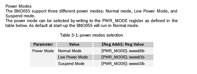

Thank you so much for the reply! I think there are 3 modes as per the sensor datasheet. 0x02 is for suspend. What is it for Low-Power where only the Accelerometer is active?
You'll have to write your own function to do this since the base Adafruit library does not have a function written to do this. Fortunately, the datasheet tells us what value to put into the PWR_MODE register here:
What you can do is go into the Adafruit BNO055 library and insert a function like so:

myIMU.enterLowPowerMode();
Thank you so much!
