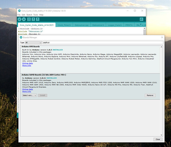

Setting up Arduino IDE on my new computer and the Board Manager is missing all of the Adafruit boards.
Did you add the json package in file -> preferences -> additional boards manager urls? I think that that will be required for Adafruit boards.
Missed that thanks
