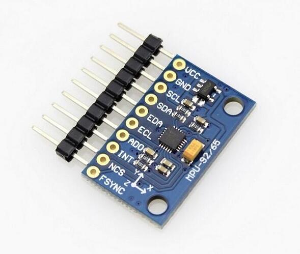

1x 9axis DOF Accelerometer Gyroscope and compass module -

The 9axis DOF Accelerometer Gyroscope and compass module probably uses 2 (I2C) pins.

Interesting project. You'll want to do some serious filtering on the accelerometer data on bouncy water. Maybe even PID.

AHRS 3 Axis Gyroscope, Accelerometer, Magnetometer and a Fusion algorithm
https://www.roboteq.com/index.php/component/virtuemart/343/riox1216-ah-detail?Itemid=1161
I just learned about this thing today, you can use it separate but it is designed to work with roboteq controllers.
I think the magnetometer can be the compass, it's for marine purposes but a new model is coming soon...
Also there are arduino's with gyroscope and so on banggood.com...cheap and copy ones.
