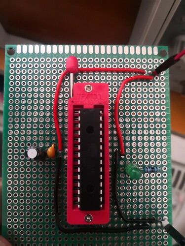

I'm trying to make my own board with a ATmega328P, and I would like to begin as simple as possible. So now I connected only VCC/GND/AVCC/AREF, and a LED on D13. As far as I understand the ATmega328P has an internal reset pull-up, which is quite weak but still usable. I have compiled the bootloader for 8MHz and 38400 baud, and adjusted boards.txt, and everything is running quite well on my Uno board.
But when I put the chip on my perfboard, the bootloader doesn't run, and it goes staright to the application code, thus I can't upload code (without a programmer). If I manually touch RESET to GND, then the bootloader runs after reset. If I manually hold RESET to GND before powering up, then the bootloader runs as well (after I release RESET). But if I power it up without RESET connected to anything then the bootloader doesn't run.
Could anybody give me some help? Thank you very much.

Could you show a photo and/or a schematic ?
Then we can tell to connect both GND pins, not to connect AREF, and ask where your decoupling capacitor are. The decoupling capacitors are important, they really are.

The decoupling caps are 4.7uF + 47nF, I think it's OK.
