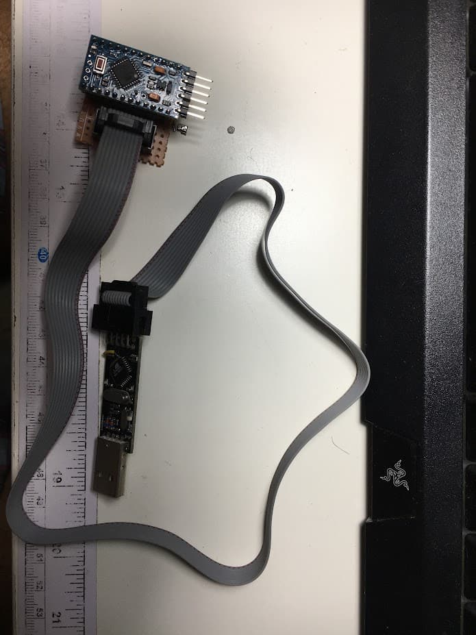

Hi there,
recently purchased some cheap pro-mini boards and I'm having issues with burning a bootloader for them.
This is 5v 16Mhz version.
D:\Program Files (x86)\Arduino\hardware\tools\avr/bin/avrdude -CD:\Program Files (x86)\Arduino\hardware\tools\avr/etc/avrdude.conf -v -patmega328p -cusbasp -Pusb -e -Ulock:w:0x3F:m -Uefuse:w:0xFD:m -Uhfuse:w:0xDA:m -Ulfuse:w:0xFF:m

         Programmer Type : usbasp
         Description     : USBasp, http://www.fischl.de/usbasp/
avrdude: auto set sck period (because given equals null)
Reading | ################################################## | 100% 0.02s
avrdude: Device signature = 0xffffff (probably .avr8x_mega) (retrying)
Reading | ################################################## | 100% 0.01s
Error while burning bootloader.
avrdude: Yikes!  Invalid device signature.
         Double check connections and try again, or use -F to override
         this check.
avrdude done.  Thank you.
Anyone have an idea?
do you have an usbasp programmer? how did you wire it to the Mini?
Aren't ProMinis supposed to come with a bootloader? Just curious as to why you want to burn a boot loader?
Yes I used a usbasp programmer.
Yes they are, for some reason bootloader stopped working. Meaning code upload from serial didnt work. So I though of burning the bootloader with the usbasp programmer, hence this issue came about.
If avrdude can't read the device signature, then it's likely a wiring issue between your ProMini and the usbasp programmer. As @Juraj asked back in post #2, what wires did you connect between the ProMini to the usbasp programmer, and where did you connect them?
@markd833 wiring issue cannot be because I have another board which I bought together with this this faulty one, and it has no issue burning the UNO bootloader with this same setup.
My programing tool setup;
then check soldering of SPI pins on the bad Mini.
checked with a multi meter for continuity and re-soldered all the joints.
Have good continuity.
Issue is still same.
However, I realize the chip is warm and that is unusual right?
Guess I might have toasted the chip while playing around?
Yes, it's probably damaged.
