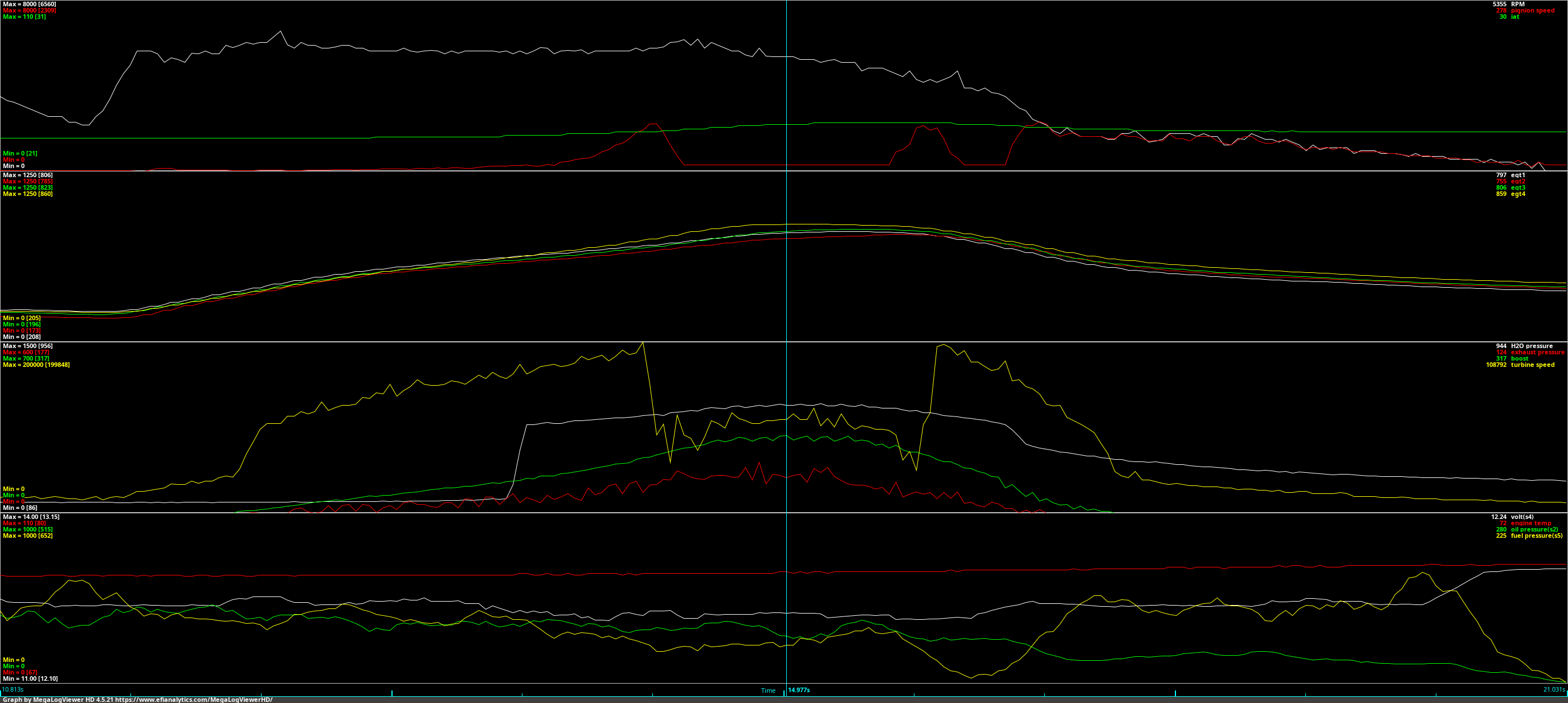

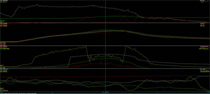

I have a 7 blade wheel and drilled the sensor on those so it has 7 pulses per rotation (at a BW turbo it would also count the lower blades so 14) at 120Krpm that would mean 71uS interval.
The turbo is mounted on a small diesel tractor puller so testing isn't as easy as on a driveable car so I have to do that during the pulling season, did a small test yesterday and if I forget the 8/divider it's starting to build 32Kpa pressure at 9475rpm which sounds reasonable for a HX50 with 73.5mm turbine wheel, multiplied by 8 would mean 75Krpm and with that speed halfway the compressormap it would make a whole lot more air then 32Kpa on a 2liter engine.
I did look at a faster cpu then the Mega but it's a complete datalogger based on automotive 5V sensors so using another platform at 3.3V it would mean a redesign of my extension board, maybe next winter. I have a touchscreen attached and had to build my screen data refresh rate in blocks so it doesn't interfere with my data collection rate, for those who is interested:
Working!
