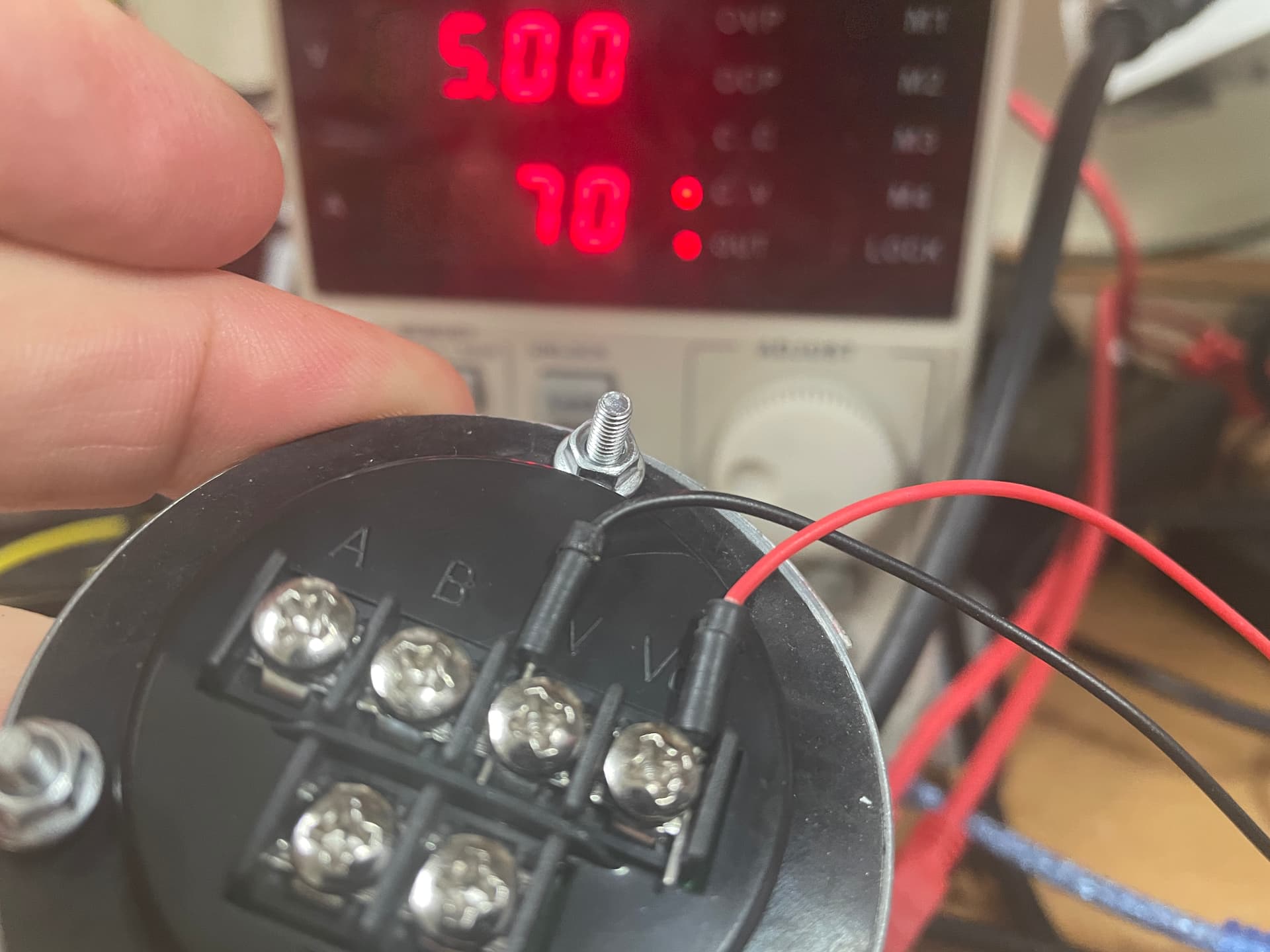

This encoder wheel is not a passive device, it needs 5v and takes about 70mA.
I tried to feed it with 5 volts from the Arduino mega, but that might be too much for the mega...
So I connected the power supply and I am getting nice quadrature signal.

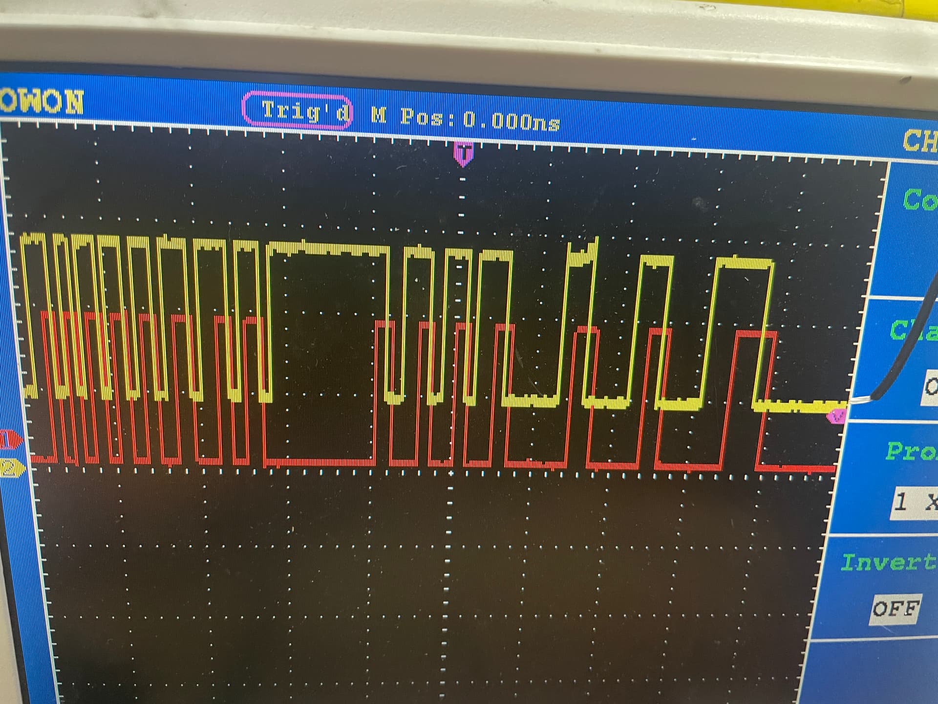

Next I put the A and B to the Arduino inputs 21 and 20 and hope to get encoder signal.
But I did not. I put the scope probes on it and the outputs of the wheel are high all the time. The high comes from the Arduino encoder.h library that does an input-high on the 2 pins allocated to the encoder. That is what I assume. Right?
In that case what to do? Try another library?

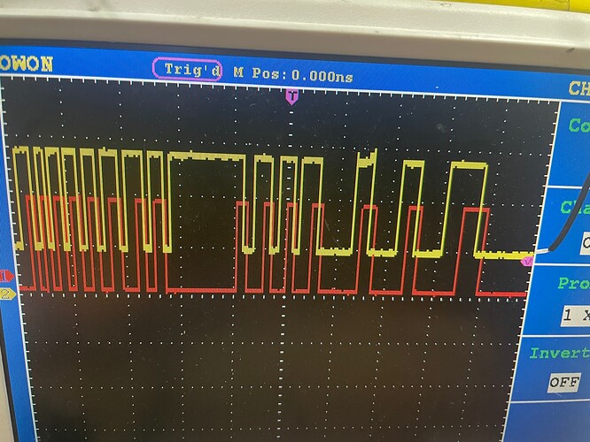

What's the volts/div on your 'scope in that picture?
Also, look where the "zero" marker is for channel 2 vs where the output signal low level is. Same for channel 1; the lows for it are below the zero level. This indicates that the A+ and A- signals are, in differential mode and referenced to one another, not necessarily ground; same for B+ and B-.
I still feel like you need to use a differential to single-ended converter like I linked to above.
The oscilloscope is on a 2 v per square mode. So the amplitude should be enough. I think.
It is all referenced to the ground, and that is the common ground I use in the arduino mega.
Am I correct assuming that the "Input high" is cancelling my signal?
The differential outputs may not be referenced to ground though and this is suggested by the fact that the lowest-level in your scope shot for trace #2 is actually hovering at 2V above ground. With differential the two signals are generated relative to each other with little or not regard to GND. It's what allows RS485 to work over ~4000ft when you can't be assured that ground levels won't be the same.
It also works in electrically noisy environments; transmitted differential data over twisted pair may see significant noise but because it would be common-mode the receiver would reject it.
My ground wiring was faulty, I crimped a wire too hard and I broke it inside the ground connector at the Jog wheel.
Now it works like a charm.
