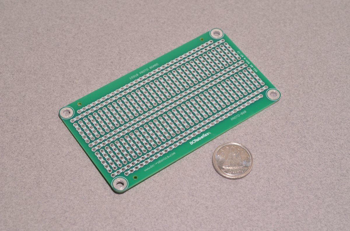

I have a small project that I'm ready to move on from my breadboard to something more permanent. Because I have a 4 channel relay module, I really rely on my breadboard's power strip for power and ground.
What are my other options for a breadboard power strip? I know I can get a pcb board and solder each hole together in a line. Or I think I should be able to also get pin headers and solder the tips together which seems to be the easiest and cleanest way of having a row of power and a separate row for ground. That should work, right?
Use stripboard.
You can cut pieces with as many strips as you need.
Or you can get a version which resembles your breadboard.
No need to make solder bridges!
