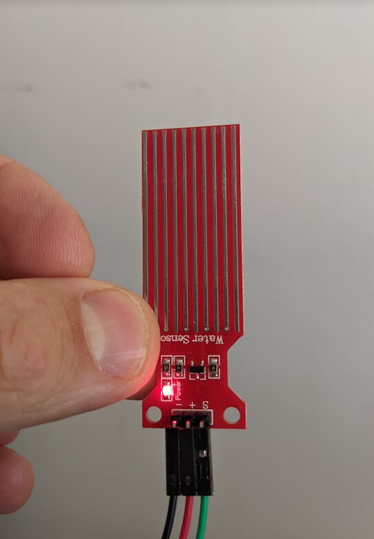

Also... I can 3D print. But... how do I turn the three wires coming out of this into a proper cable? Ideally I assume without using dupoint jumpers?

I don't know what it was before, but no, it's not so great as a way to illustrate the schematic of your circuit.
> [@mercmobily](#):
You can solder wires to the pins, or even remove the pins altogether and solder wires to the PCB directly.
