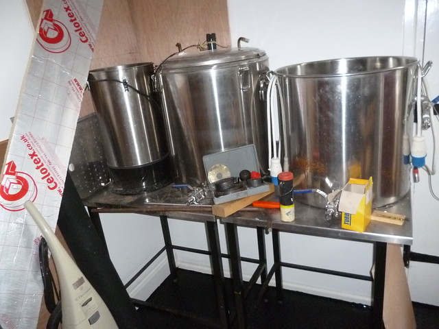

here is some of the brew h/w in the shed under construction

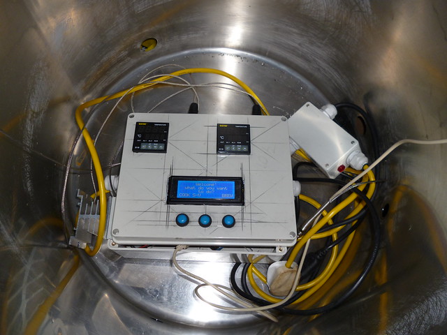

and the troller with 2 backup pids when running jabbas code base

Nice equipment, and the shed dedicated to brewing is tops. Oh the joys of brewing beer. :smiley:
