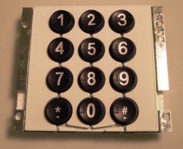

Here are pics of the old and new keypads. As you can see the new keypad is a different form factor. I don’t have any drawn schematics yet. Not sure there is going to be much in the way of wiring as I have the old keypad plugged directly into the Arduino and I’m hoping I can plug the controller directly into the Arduino.
Sorry I can only put 1 pic in a post but here is the new keypad.
Yes. You can use analog switches or analog selectors to connect any of the five ROW pins to any of the five COLUMN pins.
You will need 7 data pins. Each of the selectors will have three address pins and an enable pin. The two enable pins can be connected to the same output. Turn off the enables, set the ROW address and COLUMN address pins, and turn on the enable to 'close the switch' at that row and column.
