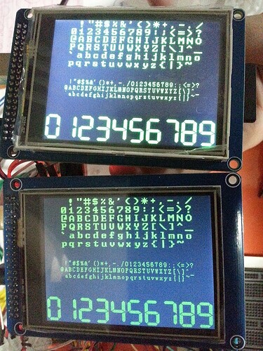

Hello to all.
I have two sets of Mega2560 + shield + tft displays. Arduino boards and shields are identical, but displays are not. One of them has TFT_320QVT_9341 printed on his back and the other has TFT_320QDT_9341.
Both displays are working fine with UTFT libraries and examples downloaded from Rinky-Dink Electronics. Codes using UTFT myGLCD(ILI9341_16,38,39,40,41) and UTFT myGLCD(CTE32_R2,38,39,40,41) works fine, no difference in performance.
The problem is that 320QVT is much more brighter than 320QDT. Although the pictures show a small difference, it is big. I have tried using setBrightness and setContrast, but they are useless.
I'd appreciate your help to understand the reasons for this difference and how to improve the 320QDT's brightness.
Thanks for your help.
You have forgotten to unpeel the plastic film on both of your displays.
One is a lot brighter than the other. There will be a small value series resistor in the backlight circuit. Change it.
Untested. I do not own either of your displays or adapter shields.
There is little point in using a variable backlight. You either want it on (with a sensible brightness) or off.
I assume that you have two 40-pin adapter shields. You might find it easier to modify the adapter than the display i.e. add / change LED series resistor.

Looking at Google images of TFT_320QVT_9341 and TFT_320QDT_9341 pcbs.
R5 "looks" like the LED series resistor. You should be able to read the value or test with a DMM.
And it would not be too difficult to change R5.
Since the label says LED_A or LEDA, it is probably an anode.
Look at your adapter shield. What does it do with LED_A pin? e.g. is there another series resistor?
Sort out your hardware first.
