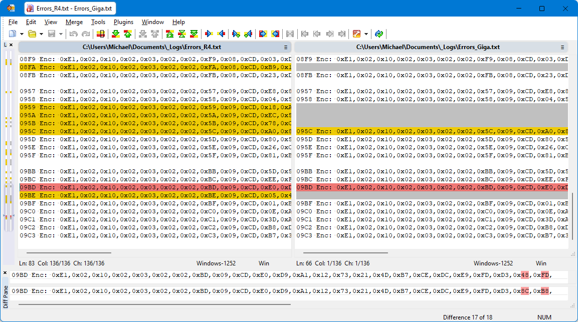

Occasionally the broadcast data read from the peripheral is incorrect.
The same sketch running on an UNO R4 WiFi always reads the data correctly. The only differences between the sketches is the libraries and code used for the different LCDs.
The data is being read from a Victron BMV-700 battery monitor. This broadcasts an identifier, a message counter and the encrypted data over BLE. There are multiple transmissions per second but the message counter, which increments every time the data has been refreshed, only changes about once per second.
The received data is decrypted for display and is checked to see if the any of the values just read are outside of the saved minimum or maximum for that value. If it is, the value just read is saved as the new minimum or maximum. The photo below shows the invalid values (circled in red) displayed on the Giga Display Shield with the correct values (circled in green) shown on the UNO R4 WiFi LCD.
For testing the encrypted data is also logged through the serial port. This shows that the encrypted data read by the Giga is different to the encrypted data read by the UNO R4 WiFi. This indicates that the error is not occurring during the decryption. The WinMerge screen shot below shows that 2 bytes of data are different in message 09BD.
It also shows that the Giga is not receiving all the data being broadcast. On the photo above it can be seen that the RSSI shown on the Giga is -83dBm while the R4 shows -69dBm. The device being read is about 10 meters from the Arduinos.
The Bluetooth code is based on the ArduinoBLE - Central - ScanCallback example.

What antenna are you using on your giga board? -83dBm Vs -69dBm is not an insignificant difference.
I'm using the plug in external antenna that came with the board.
Maybe carefully disconnect and reconnect the antenna. Is the antenna attached to any metal casing, perhaps. Does not make sense why the rssi so much poorer.
I have disconnected and reconnected the antenna, the RSSI for Bluetooth is still around -80dBm on the Giga versus -60dBm on the R4.
The WiFi RSSI on the Giga is around -15dBm when connecting to my phone about 20cm away.
The reconnected antenna is now free in the air, previously the wire was laying across the board with the antenna located in the gap between the SCL21 and DI22 pins.
