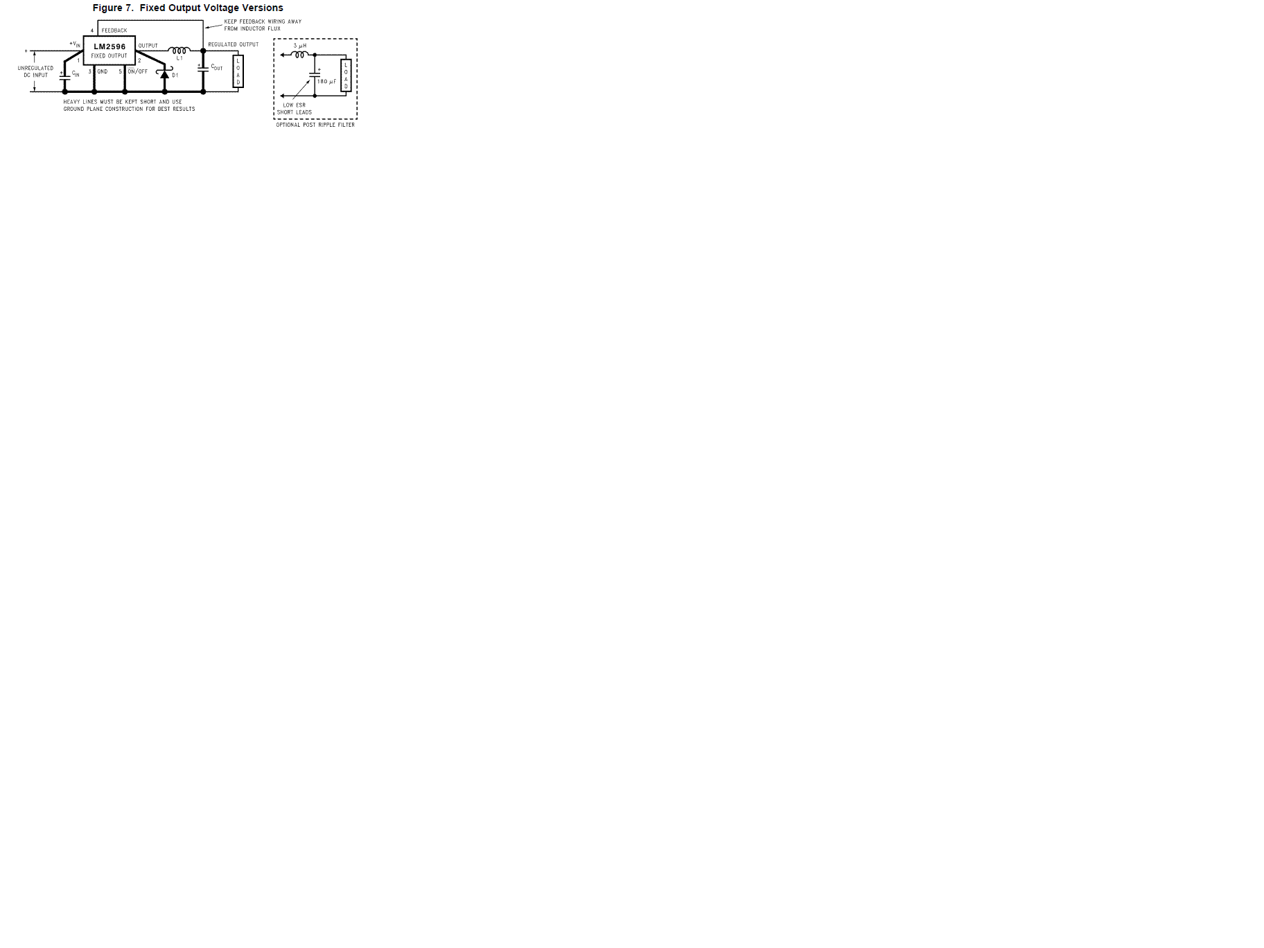

8 mil traces, buck-boost converter. OOF! Is this on the same pcb? I don't know which part
you're using, but see the picture, same idea for buck-boost,

Well the traces dealing with the converter and charging circuit are all polygons. So for instance, this is what the bottom layer looks like around the buck/boost converter (TPS63001DRCT) and the top layer is a solid ground plane with lots of vias stitching the two sides together. The thick traces leading out from there are a revision that will go in the next board. In the board that I am working on right now, they are thin traces but the polygons directly around that little SON10 package are all there.
