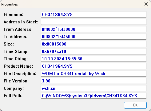

I am getting an IRQ error and a blue screen during fast data transfer on the CH340 serial port at 115200 baud rate.

Yes, it happens when it is on. I keep turning it off and on. The issue also occurs when the bandwidth is at its lowest, but less frequently.
wch CH340G
Hello again @koyuyesil and @fream478 A potential fix has been made in the serial-monitor helper tool that provides communication between the Arduino IDE Serial Monitor tool and the serial port of the Arduino board:
Arduino IDE automatically updates the serial-monitor when a new version is available, so the version with the fix (0.15.0) should already be installed on your computer and in use by Arduino IDE.
I already verified that the change another problem that affected boards with the CH340 chip (arduino/arduino-create-agent#1000). However, I was never able to reproduce the problem reported here, so I am not able to check whether it is fixed or not.
Please check to see if the problem occurs when using the latest driver version and then add a reply here on the forum topic to let me know what you found.

for the ELEGOO Arduino nano 3.0 CH340 on Amazon here are the drivers. Use the 3.0 driver 2019 not the 2022 or 2023 for Windows 10. ELEGOO Arduino Nano Board V3.0+/V3.0 CH340 USB Driver – ELEGOO Official
ELEGOO CH340 Driver 2022.09.29.zip (5.4 MB)
Elegoo Nano Board V3.0+ Driver19.11.28.zip (1.1 MB)
Here are the 2 CH340 drivers the faq suggests a small delay at higher baud rates than 9600... Serial.println("hello"); delayMicroseconds(10);
Suggest using the 3.0 drivers for win10 older 2019 driver. the 3.0+ is 2022 ver
