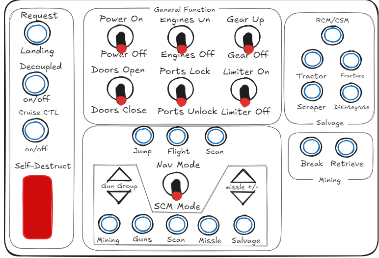

Hello all, I am trying to build a button box using PCF8575 IO expanders and I am seeing a bunch of confusing posts all with different opinions on how to wire them and code them.
## Hardware I am planning on using:
[Buttons](https://www.amazon.com/gp/product/B08L13JG8M/ref=ox_sc_act_title_1?smid=AUTFQ43Q7FMBM&psc=1)
[PCF8575](https://www.amazon.com/gp/product/B0B82L2ZCQ/ref=ox_sc_act_title_2?smid=AGTXEOAZWIVDD&psc=1)
[Switches](https://www.amazon.com/gp/product/B09W5FP2RM/ref=ox_sc_act_title_3?smid=A1MYENKL68XMV9&psc=1)
[controllers](https://www.amazon.com/gp/product/B0D83FBYPD/ref=ox_sc_act_title_4?smid=A1NOQTMMT39TJ0&psc=1)
This is the wiring diagram ive worked up. I am not an electrical guy, I am a software guy by trade. But Ive recently seen something about needing to add a resistor between the controller and the SDA and SCL pins? Any advise you could give me here would be valuable.
 ![image](https://europe1.discourse-cdn.com/arduino/original/4X/c/d/e/cded41b0d6e00657064d9cbacadebd3bab64bc44.jpeg)
## Project Description:
I am using 7x ON-ON SPDT switches, that is the Orange dots representing the 2 pins per switch for inputs.
I am using 18 LED momentary Push buttons. Button inputs are blue, LEDs that wont be lit up by power supplied to the buttons are represented in Green.
3 of those buttons I want to always be lit, the other 15 buttons are sorted into four Button Group that I only want to be lit up when certain conditions are met: ie IF(PF8575\_one.pin10 == HIGH) then (controller.pin10 == HIGH)
I am unsure where 5v is on the controller, so the power is not connected there until i purchase everything and get readouts. Same for the Interrupt, which im not sure how to use anyway.
Anyways, any advise or alterations you think should be made, I would love to hear them. Pic of projected final project below:
 ![image](https://europe1.discourse-cdn.com/arduino/original/4X/b/0/3/b036ab6eecbf64efa5ff47d3528d91a0e9b62ea2.png)

- Read Nick Gammons discussion here.
> **[Gammon Forum : Electronics : Microprocessors : Using a keypad matrix](https://www.gammon.com.au/forum/?id=14175)**
