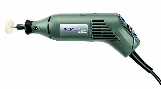

i've started to think about (and gather information) about building a home-made CNC router based on arduino. The router part would be my dremel tool .

You don't say why the Dremel was useless?
I have recently replaced my Dremel with a Proxxon mini-drill primarily because it has a much simpler and more accurate steel locating collar so it fits quickly and accurately into the Proxxon drill stand. The Proxxon also has the on-off switch separate from the speed control. When I first switched the Proxxon on I thought it was broken because I could not see the chuck rotating - it was running so smoothly.

Dremel:
dremel is plastic and is no designed for side forces on the housing or bearings.
bearings are not designed to carry away heat and are not designed to support side loads
failure is based on continuous run time. if you put an hour meter on the dremel, you should get 500 hours out of it.
does not sound horrible, but since your machine can only take light cuts, you will need to run it for hours at a time.
figure 100-300 pieces per dremel.
buy stock in the company. when you buy a new one every couple months, it will feel like you are investing in your future.
