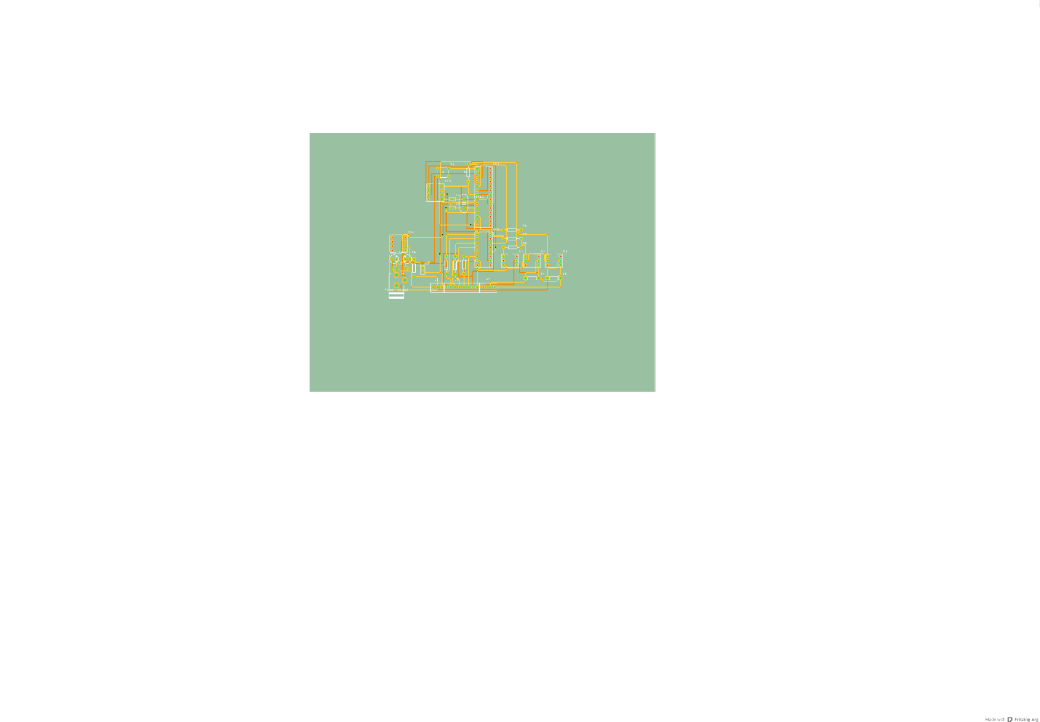

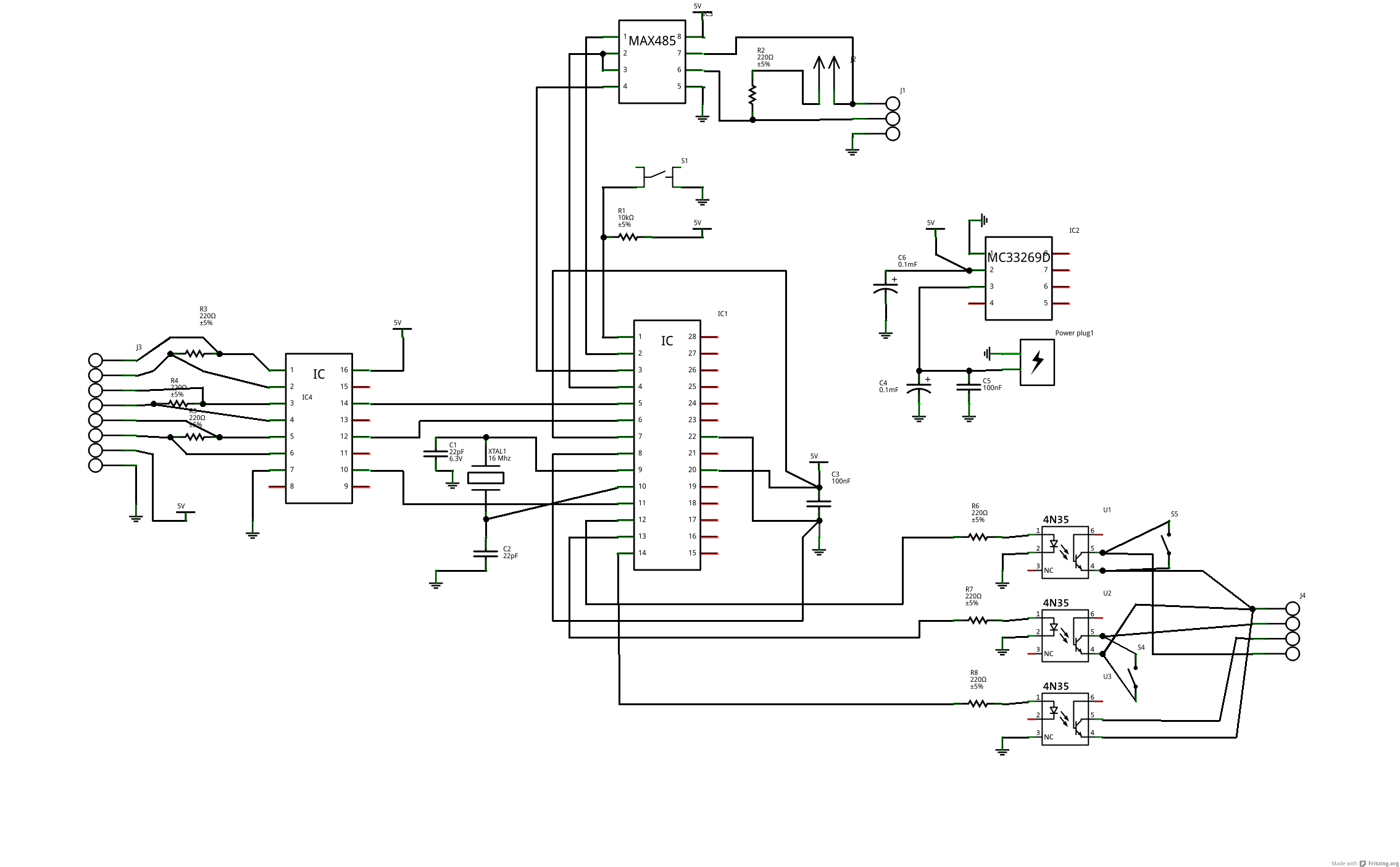

Hello.
Take a look to my project.
http://fritzing.org/projects/motion-controller/
Suggestions, tips and comments are welcome, they're a need.
Ups. J4 has an unconnected pin.
When drawing use your power and ground symbols where applicable, it cuts down on extra lines in the drawing making it more legible. Avoid drawing lines by the crow's flight, route them horizontal and vertical, make circuit lines cross at 90degree angles. Any intersection that is a connection gets a junction symbol(the large black dot). I know I sound bitchy, but I remark for your own benefit as well as for those who you are trying to enlist help from. A clean drawing can eliminate lots of errors. Speaking of errors mark all un-connected pins as such usually a red 'X'. This helps you to not leave out things too. Most PCB editors complain of unconnected pins when transitioning from schematic to a net list for routing, as it is part of the DRC (Design Rules Check).
Thank you.
I will keep your suggestions in mind.
What is IC4, as in the part number? Your pinout does not strike me as a typical 4 channel line reciever.
What are the optoisolaters connected to? If there is no pullup's on the other side of J4 pins 2-3-4) you wont see any change on the outpuuts.
ajofscott:
MAX3097. It's a 3 channel line receiver for encoders.
CrossRoads:
The optoisolators are connected to a variable frequency drive and it has internal resistors. This part is fully tested.
The circuit was tested in a hand-made shield with arduino. Now I want to make a board with an atmega328 and Fritzing.
I have made some changes and the project will be updated in Fritzing web.
Thank you.

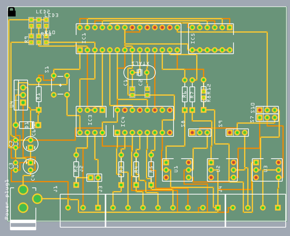

Project updated.
Two questions:
R8 and R12. I will try this trick to use trough hole or smd resistors. Is it a good idea?
S7 and S10. Fritzing hasn't got dpdt switches. Can I simulate it with two switches?
You need to use a wider copper run for power and ground. How wide? Check your prototype for current draw then go from there.
You should put a decoupling cap next to each IC. You have more than enough room on the board.
DPDT switches - can you create your own symbols in fritzing?
JoeO:
Whatever the supply current to a chip you want wide Vcc and ground traces - this keeps the stray inductance low (this allows the decoupling capacitors to do their job best. In fact you only really need the wide traces between chip and nearby decoupling cap.
A ground-plane is a good idea anyway (especially if using analog signals). If the Vcc trace from chip to decoupling cap can run opposite ground-plane and be short then this is ideal. If ground-plane isn't possible, try to make a lattice of (wide) ground traces that cover the board area.
Typically you'd have the power traces 2 to 3 times the width of signal traces (this is also helpful to humans as it makes it easier to see what's what on the board).
JoeO:
OK. Now I have 24 mil traces. I think this will be wide enough.
I have moved C3 near to IC1.
CrossRoads:
Yes, I can. But I prefer to put 2 spdt switches instead make a new part. But my question is the same: will a DPDT switch fit in two SPDT?
I will add the ground plane at the end.
