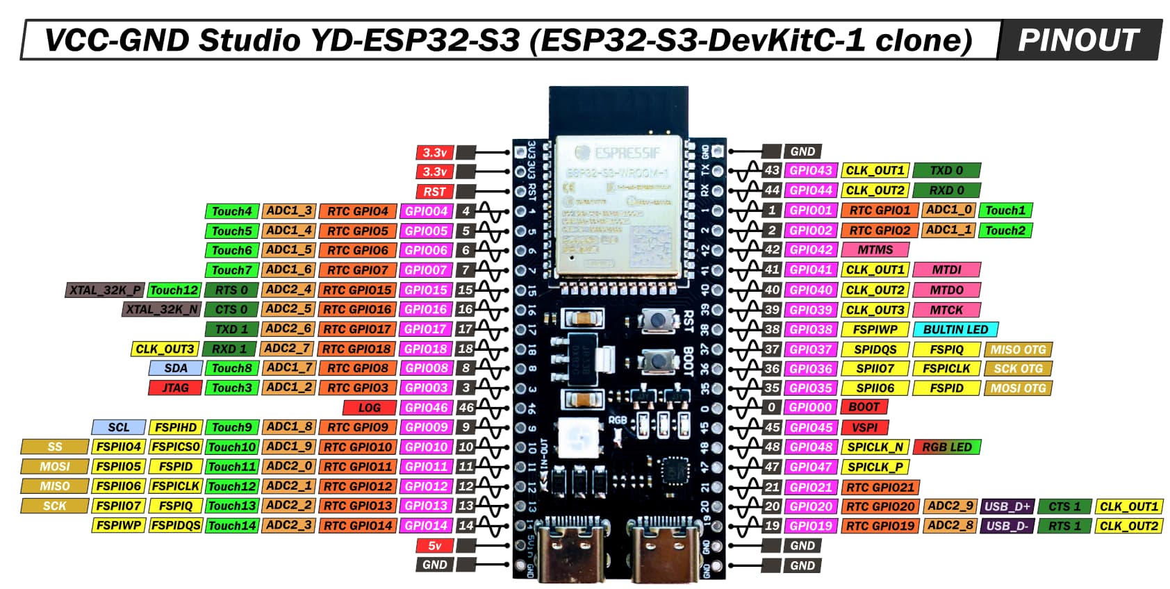

my thought is:
leave away arduinos
ESP32:
More RAM, more Flash, more clock-speed, UARTS, higher-baudrate software-serials
including I2C-Bus, I2S-Bus, SPI-bus, CAN-Bus can be driven directly
Why on earth do you want to add Arduino-Unos or Arduino-Megas or Arduino-Nanos
when ESP32-boards have 8 to 43 IO-pins?
