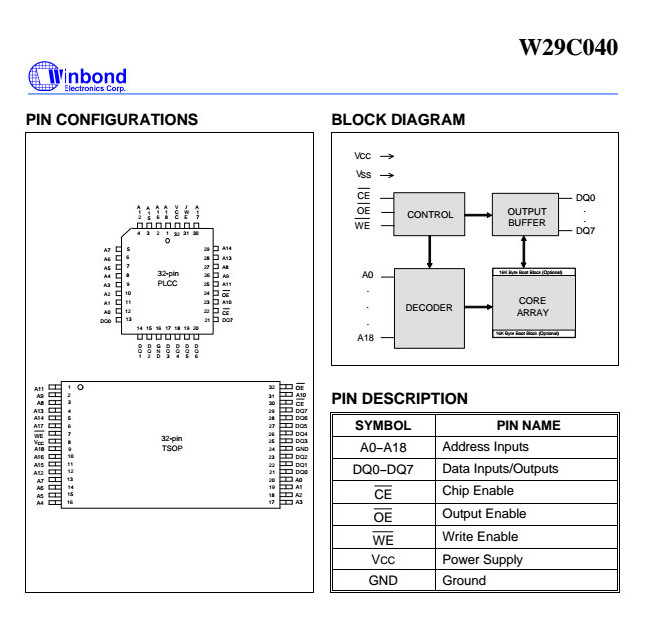

I have two SRAM chips part named HM6268P-35 which both have 4096 Byte of Static SRAM TTL compatible memory , for each.
Then I have one Winbond W29C040-90, named, preprogrammable (with 5V programming voltage, 12V is no needed, which datasheet says.) It's memory capacity is 8x 512KB which all is shared for units which each contain 256 bits.
All those memory chips and both ALU's are pin compatible for prototyping them in breadboard, so what is number one thing and the information which O have hard time to find answer is can I use arduino mega 2560 to program the flash chip? What's the hardware programming schematic/connection diagram to arduino and need some code...That winbond chip contains already some programmed areas. Datasheet says there are some logic device inside it too, not memory only that's is etc. logical unit for erasing, programming etc. buffer. Memory already have too 16KB boot-ready sector

My sram chip datasheets have clear picture where is some logic gates and row decoder etc...so everything seems to be like any basic ram memory chip schematic, but Winbond chip datasheet circuit schematic only shows very simplyfield diagram of logic gates here is picture from datasheet where is pin configuration too(from some reason there is now pin configuration for DIP package..)
![|403x500](http://http://snag.gy/cJ7K7.jpg
Here is sram chip's logic diagram as well:
Here are both memory chip's pin configuration and schematic
