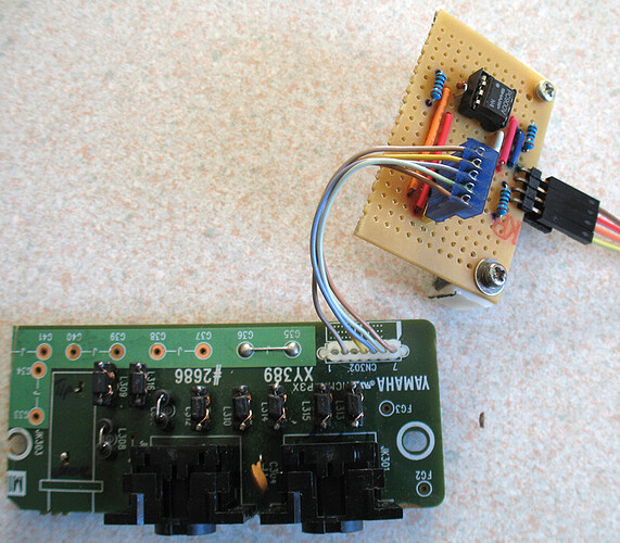

I've built a MIDI in/out circuit with a PC900V optocoupler and it lets me send MIDI to my Arduino UNO.
