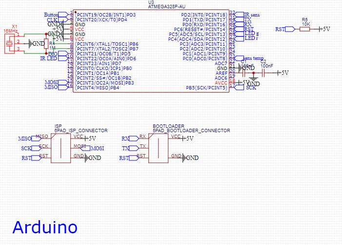

Hi
I ordered a custom made pcb and soldered among other components an ATmega328p-au (solder joints are looking good) and tried to burn the Arduino bootloader on it using my Arduino Uno and the example sketch in the Arduino IDE. Which didn't work.
I got the following error messages:

And if I apply pressure to the jumperwire / board connections:
Error while burning bootloader.
Reading | ################################################## | 100% 0.02s
avrdude: Device signature = 0x111131
avrdude: Expected signature for ATmega328P is 1E 95 0F
         Double check chip, or use -F to override this check.
avrdude done.  Thank you.

I expected my PCB design to be faulty. In order to test my theory I tried to reburn the bootloader on my Arduino Uno using the Arduino Mega, but this didn't worked either.
Mega > Uno
Pin 51 > 11
Pin 50 > 12
Pin 52 > 13
Pin 10 > Reset
Pin 5V > 5V
*Pin GND >GND *
This leads me to the conclusion that I am doing something wrong during the upload.
I mean my design could still be faulty but yeah xD.....

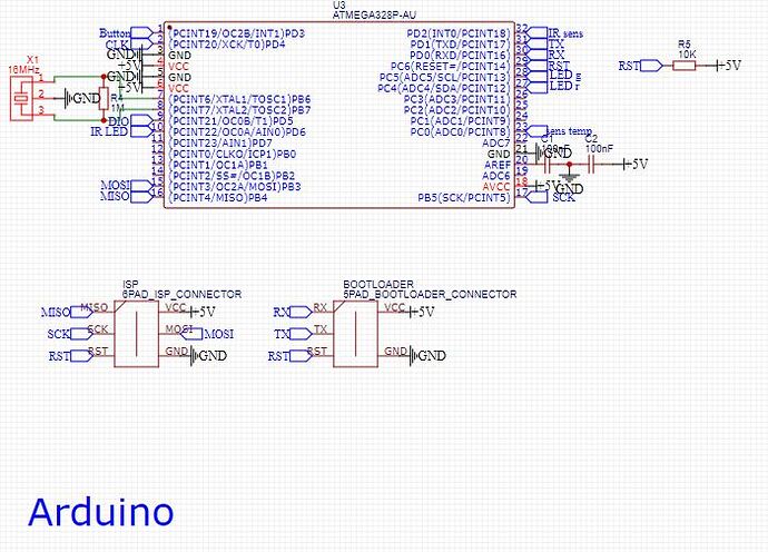

I have attached a screenshot of the part of my PCB schematic with the custom Arduino
I tried to provide all information necessary, but if you need anything else just ask.
Can anybody please help me with my problem?
Where is the capacitor on RST?
aarg:
What do you mean? The ATmega328 doesn't need a capacitor on reset, does it. As far as I know the cap is only needed if you have the USB to serial converter on the board. Am I wrong?
Or do you mean the capacitor on the Programmer Arduino? I tried it with and without a E-cap between reset and GND on the Mega
Check your jumper wires for continuity. Sometimes you will get jumper wires that have a broken or intermittent connection.

So I tried it with new jumpers on my own PCB design and it's still not working there.
Which brings me back to the suspicion that there is something wrong with my design.
The random or all zeros signature can definitely be caused by a wiring issue. Here are some raw notes I made from when I was experimenting to try to find correlations between different possible wiring issues and the resulting error messages:
  • avrdude: Device signature = 0x000000
  • Target not powered.
  • MISO/MOSI/SCK/RST not connected
  • MOSI/SCK swapped with RST
  • MISO swapped with RST
  • RST-RST instead of 10-RST reset connection
  • ICSP cable backwards on header
  • `avrdude: Device signature = {some random wrong signature}
  • MOSI/SCK swapped with MISO
  • avrdude: Device signature = 0xffffff
  • MISO/RST swapped
Does your custom board have a crystal or resonator to set the ATmega clock? If not, and the chip is set to expect a crystal, the chip's clock is not running. Serial programming requires the chip clock to be running.
Adafruit has a version of the ArduinoISP sketch that provides an 8 MHz clock on Pin 9: GitHub - adafruit/ArduinoISP: A fork of the ArduinoISP that has 8mhz output clock Upload this version of ArduinoISP to your ISP Arduino. Connect Pin 9 of the ISP Arduino to the XTL1 pin of the ATmega168/328P. That will provide an 8 MHz clock to allow programming without a crystal.
johnwasser:
I am using a ceramic resonator (CSTCE16M0V53-RO Ceramic Crystal SMD 16MHZ) but I didn't implement any 22p caps from the resonator to GND (because my research at that time showed that they weren't necessary if you are using a resonator instead of a crystal. But I am not sure anymore).

Are you uploading via the "5PAD_BOOTLOADER_CONNECTOR" shown on your schematic? If so, what do you have connected to it?
pert:
Yeah exactly these are just 5 pads to connect wires to. Very similar to the connector of an Arduino Pro Mini.
I used the Arduino Uno to program my board the same way I programmed my Pro Minis successfully (I actually tested it and reprogrammed one of my minis successfully)
This shouldn't be a problem, right??
The reason I asked is because the ATmega328P must be reset at the right time during the upload. If it isn't reset, you get this error message (though there are a bunch of other possible causes too). On the Pro Mini, you connect the DTR or RTS pin of the USB to serial adapter to the "GRN" pin on the Pro Mini's "FTDI header". That "GRN" pin is connected to the ATmega328P's reset pin via a 0.1 uF capacitor. That generates the pulse that resets the board when the connection is opened to start the upload. Your board doesn't have this 0.1 uF capacitor.
When using the Uno as a USB to serial adapter, I suppose if you connect the Uno's reset pin to the reset pin on your custom board you'll be able to use the reset pulse generated from the Uno's auto-reset circuit? Is that how you have the Uno wired to your board.
How do you have the Uno's RX and TX pins connected?
There should be a 0.1uF cap between DTR on the FTDI connector, and the RESET pin. Since a typical FTDI doesn't have this, it has to be on the target board. That is the cap I referred to earlier.

I connect the Reset pin of the Uno to GND (this way the MCU on the Uno gets [ignored]) and press the reset button on the Pro mini at the right time. The timing doesn't need to be that precise (at least with the Pro Mini and since they are using the same MCU it should be the same thing)
Uno > custom board / Pro Mini
RX > RX
TX > TX
5V > 5V
GND > GND
I know that you wire it RX > TX and vice versa. But that's how it worked on the Pro Mini. And I even tried both ways just to make sure. And yes I am planning to purchase an FTDI module, but I didn't had any problems using the Uno so far...
I think the problem is with the bootloader. But I might be wrong since I don't have that much experience.
Don't get me wrong please, I am really thankful for your suggestion.
m4tthias98:
I am not using the DTR pin. I connect the reset pin manually to ground at the right time (same way I do it with the Pro mini successfully)
OK, that works, as long as you reset at the right time. The trick is that when you click the Upload button in the Arduino IDE, it first compiles the sketch, then starts the upload. So if you reset the board when you click the Upload button, the bootloader will have already timed out by the time the upload starts. The time to do the reset is when you see the sketch size printed out in the IDE's console pane.
However, that actually isn't an issue on the first upload after burning the bootloader because until that first sketch is uploaded the bootloader runs constantly and so no reset at all is needed on the first upload.
m4tthias98:
The timing is dependent on how long the bootloader runs before timing out. If I remember correctly, the outdated "ATmegaBOOT" bootloader of the Pro Mini has a longer timeout duration than the modern optiboot bootloader used by the Uno and the default Nano board setting.
m4tthias98:
RX > RX
TX > TX
5V > 5V
GND > GND
Looks good.
m4tthias98:
This is an odd situation where making the connections RX-RX, TX-TX according to the markings on the Uno actually results in the correct RX-TX, TX-RX connections. The reason is because the RX and TX marked on the Uno's silkscreen is referring to the pins on the Uno's ATmega328P but you aren't communicating between the Uno's ATmega328P and your custom board. Instead, you are communicating with the USB to serial adapter chip on the Uno. That chip has an RX-TX, TX-RX connection to the Uno's ATmega328P.
