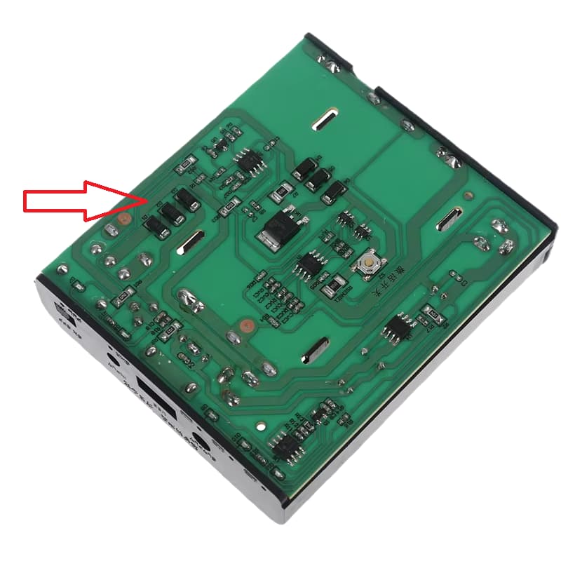

I was working on a voltage divider to measure battery voltage with an ESP32. Unfortunately, during testing, there was a short circuit between the + and - terminals due to a stray wire that I didn’t notice. As a result, some components burned out and are no longer part of the circuit. These components are labeled D1, D2, and D3 in the image.
I’m not sure if this is the right place to ask, but can someone help me understand the function of these diodes? I've tested the power bank with a 12V water pump, and it still works. However, since I’m planning to use this as a battery backup for a solar panel setup, I’d like to know what protection function might have been lost, and if I can repair it by soldering replacement diodes myself.
Thanks in advance for any help!

Hi, @drunkly
Those three diodes are in series, can you reverse engineer the two connections to where they go?
By the looks of the track widths and solder joints, it looks like a major part of input or output power.
Tom... 😃 👍 ☕ 🇦🇺

If you burn three diodes in series (quite an accomplishment!), how can you be sure that the mosfet was not burnt?

> [@drunkly](#):
How do you know they are burned out?

> [@TomGeorge](#):
I will try later and tell yout the results
> [@build\_1971](#):
To be honest, I can't, probably they are, or probably they are not, if there is a way to be sure of that I don't know it 😅
> [@jim-p](#):
Because the wires get really hot almost meld, a smoke came from the box, and when I open it, the place where were this diades are smoked and the dioedes weren't there, I will attach an image asap when I arrive home.

If things have melted off your board, it may well be beyond repair...

Thanks for the advice. I'll try to repair it as soon as I can figure out what type of diodes they were and their voltage and current ratings. Unfortunately, since they are burned and I don't have the original schematic, it's hard to know exactly what to replace them with.
On the other hand... isn't weird 3 diodes burn if they are in series? I thought as soon as the first diode burnt, the next and previous are on a "open circuit line" and can't get current so they act also as a fuse, Or could it be that the excessive heat from the first diode burning caused the other two to desolder themselves?

There may be many other components that are damaged. I would take out the batteries and save them for a future project and throw the rest in the trash.

All 3 diodes probably failed shorted when they rapidly became blobs of molten silicon!
