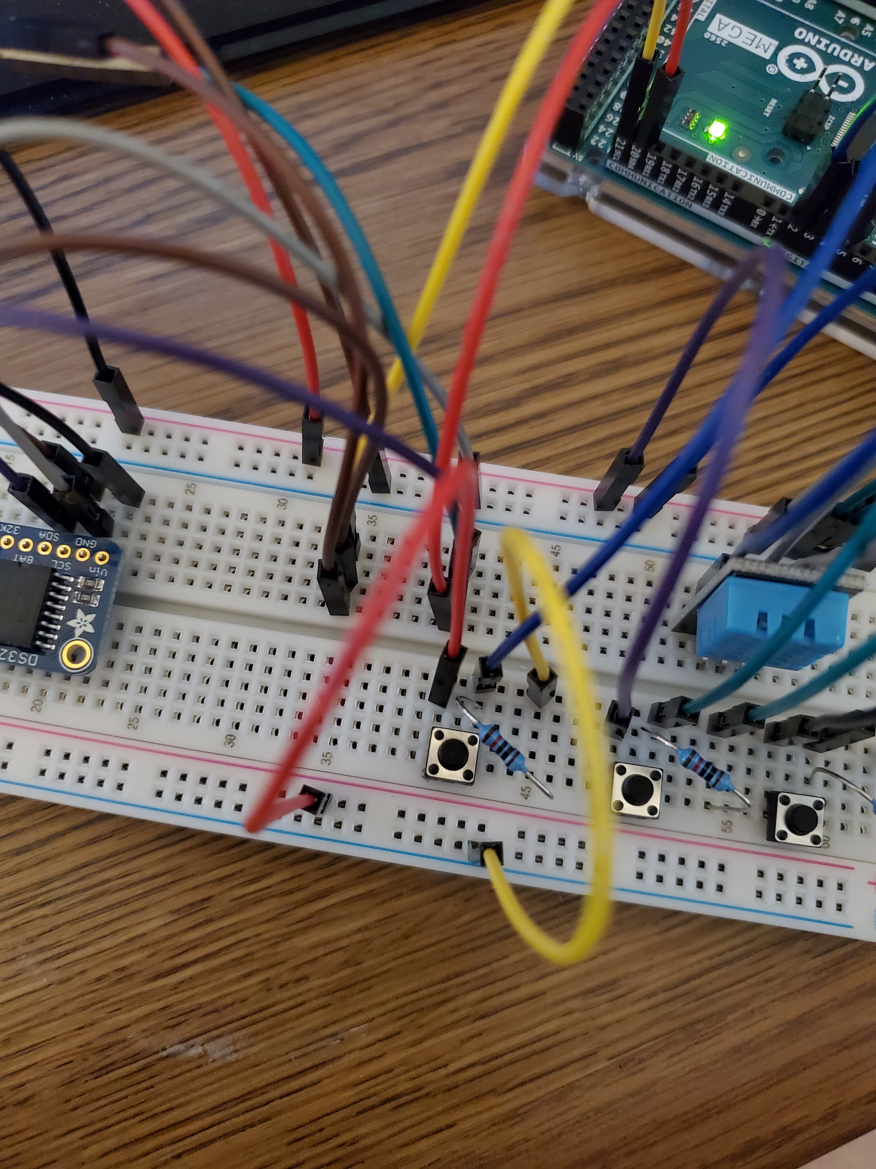

My code is pretty long, scroll down to the comment saying "broken below here" for the part concerning the button. The button is supposed to increment a number and display it on a screen. Sometimes it works and sometimes it doesn't, I suspect it is a problem with my button1state and lastbutton1state if statement. If some of the code is not clear I can explain it.

//BROKEN BELOW HERE
while (alarmpage == 1) {
button1state = digitalRead(button1pin);
button2state = digitalRead(button2pin);
button3state = digitalRead(button3pin);
if (alarmstart == false) {
lcd.clear();
lcd.print("Alarm Time: ");
lcd.setCursor(0, 1);
lcd.print("00:00");
//alarminitialize = 1;
if (button1state == HIGH && lastbutton1state == LOW) {
alarmhour++;
lcd.print(alarmhour);
lcd.print(":");
lcd.print(alarmminute);
alarmstart = true;
if (digitalRead(3) == HIGH) {
alarmminute++;
lcd.print(":");
alarmstart = true;
if (digitalRead(8) == HIGH) {
exitbutton = 1;
if (exitbutton == 1) {
alarmpage = 0;
lastbutton1state = digitalRead(button1pin);
