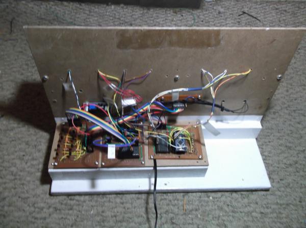

this is a tinker test machine i'm building, 8 buttons select options, 8 led's light up led's to the button selected. i choose the 74ls154 because i needed the extra outputs. arduino handles input buttons outputs to 74ls154... that's it. nothing else... so when it's not doing anything it should just be scanning the buttons and waiting.

as a thank you for all your help guys... here is what i'm working on... it's a miniature drink serving machine that i came up with, just testing ideas...
