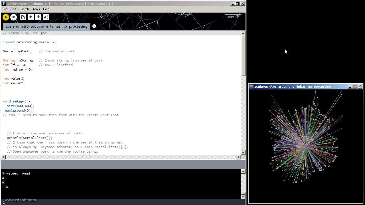

Projects like this:
https://www.youtube.com/watch?v=ZYyyaJgKsDg https://www.youtube.com/watch?v=6ijArKE8vKU https://www.youtube.com/watch?v=SI1w9uaBw6Q https://www.youtube.com/watch?v=Lu_HKSNK5bI
I understand that are not precise calculation coords, because of the "digital noise" and gravity factor, but using filter like kalman and similars they can correct a little or so they say in several places.
No matter if it's not entirely accurate, I want to try and experience if I can improve accuracy using OpenCV, so I was interested in the calculations.

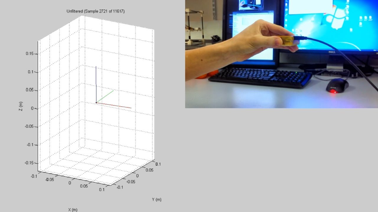

If you like videos, see this one: https://www.youtube.com/watch?v=_q_8d0E3tDk Title: "Pure IMU-based Positional Tracking is a No-go"
