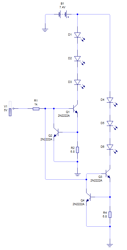

Hello,
I need to wire 6 LEDs they have a forward voltage of 1.2 to 1.4 and require 100ma
the schematic I have attached, I have put values in but I'm unsure.
can someone advise me, but id also like to understand the calculations for future knowledge?

You need to understand Ohm's Law and Kirchhoff's circuit laws, these are basic to all electrical circuits and the answer to your question comes from understanding them.
You have 7.4V from the battery. You say the LEDs have a Vf of 1.2V to 1.4V. Taking 1.4V, subtract that from 7.4V, giving 6V.
Current is calculated as V/R, so with the values you have 6/470 = 12.7mA.
Resistance is calculated as V/I, so for 100mA 6/0.1 = 60 Ohms.
Also, if you apply 5V directly to the transistor base it will die. You need a resistor, same calculation as for an LED. Vf for a base - emitter junction can be assumed to be 0.6V for a silicon transistor.

modified circuit is attached.
Very wasteful use of the battery.
You can have three of those LEDs in series (3*1.4volt = 5.2volt), and the remaining 2.2volt across the resistor.
So two strings of three, with two 22 ohm resistors.
That would use 200mA instead of 600mA.
R3 current should be calculated for 5% (5-10%) of the collector current.
Totally off in that diagram (~2mA instead of the required ~45mA).
The 2N2222 will not saturate, and LED current is not what you calculated for.
Three LEDs in series would make LED current more dependable on battery voltage.

Of course, using a resistor and one LED from 7.4 V was essentially constant-current drive. :grinning:
So changed it to parallel series but i have no clue about constent current circuit
Your circuit will work, but the 2N2222 will burn out with that low base resistor value.
Change R3 to 220 ohm.
Or use two of Paul__B's circuits, one for each LED string of three.
Change the 3k3 resistor to 1k, the 'R' resistor to 6.8ohm (standard value), and the LED transistor to a 2N2222.
Don't use a 22 ohm resistor in the LED string if you use that constant current circuit.
Leo..
Couple of interesting things.
The BC547 is actually not appropriate for this task as its collector current maximum continuous rating is 100 mA. Its gain at this current however exceeds 100 so the 3.3k resistor would actually be adequate (just) to bias it, and probably also for a 2N2222. Yes, 1k would be better. Not my own graphic!
And yes, it is the β (HFE) that is relevant in this case. The transistor is not saturating.
So using the values you have provided, know I have done the constant current circuit twice and can both be controlled by a single pin from arduino?
Almost correct.
There also must be two 1k resistors, joined at the Arduino pin.
Q2, Q4 can be small signal transistors, like BC547/548 2N3904 etc
They only pinch off base current for the LED driver when it reaches >=100mA.
IR LEDs drop about 1.4volt@100mA, which means that you can have up to four LEDs in the string.
Leo..

Circuit is quite simple.
The 2N2222 gets sufficient base current from the Arduino pin that could draw several hundred mA through the LED string. That current builds up a voltage across the 6.8ohm emitter resistor.
When the voltage reaches the BE threshold (~0.65volt) of the 2N3904, that one starts to conduct, and channels some of the base current for the 2N2222 to ground.
The 2N2222 is the throttle, the 2N3904 is the brake. They both settle at ~100mA.
Seems you are using the LEDs for an IR spotlight, for a camera?
With three LEDs in a string (Vf~4.2volt), about 40% of the power is used (wasted) in the transistor.
A fourth LED just gives you a bit more light at no power cost.
Five LEDs in a string (Vf~7volt) is pushing it when the battery goes flat.
Six LEDs in a string (Vf~8.4volt) is not possible on a ~7.4volt battery.
Leo..

so I have redesigned the headpiece to accommodate the extra 2 LEDs, do I need to change the resistors the 6.8?
The 6.8ohm resistor just sets the 100mA current through the string.
No changes needed if you add another LED.
