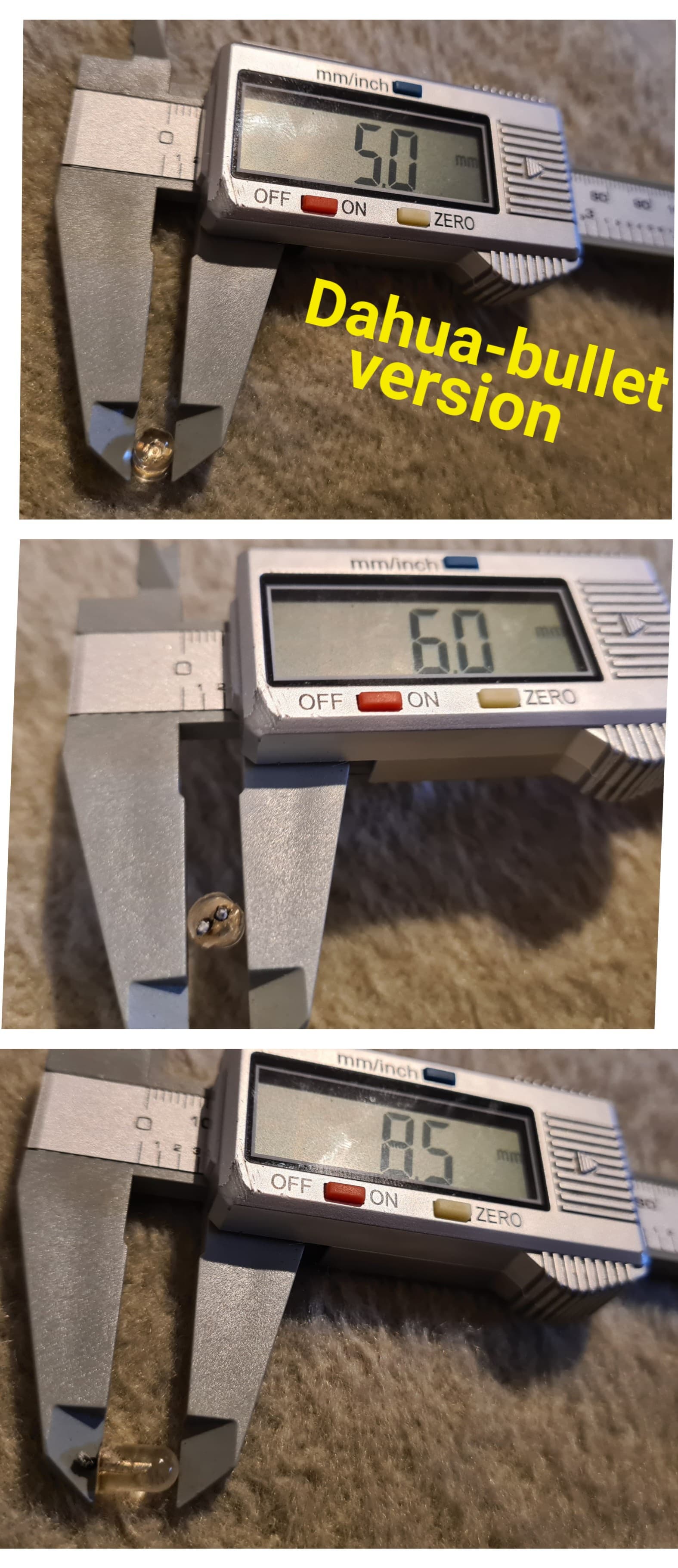

Here are dimensions of that two types diodes and marks on board, maybe someone can recognize something:

Which can be better in dark for picture? And which give "longer" distance brightness in picture? 850 nm? Or maybe they are similar.
I have that small darker in dome camera and in bullet transparent and bigger LEDs. But I think that small LEDs are newer type (dome camera bought later) and maybe stronger.

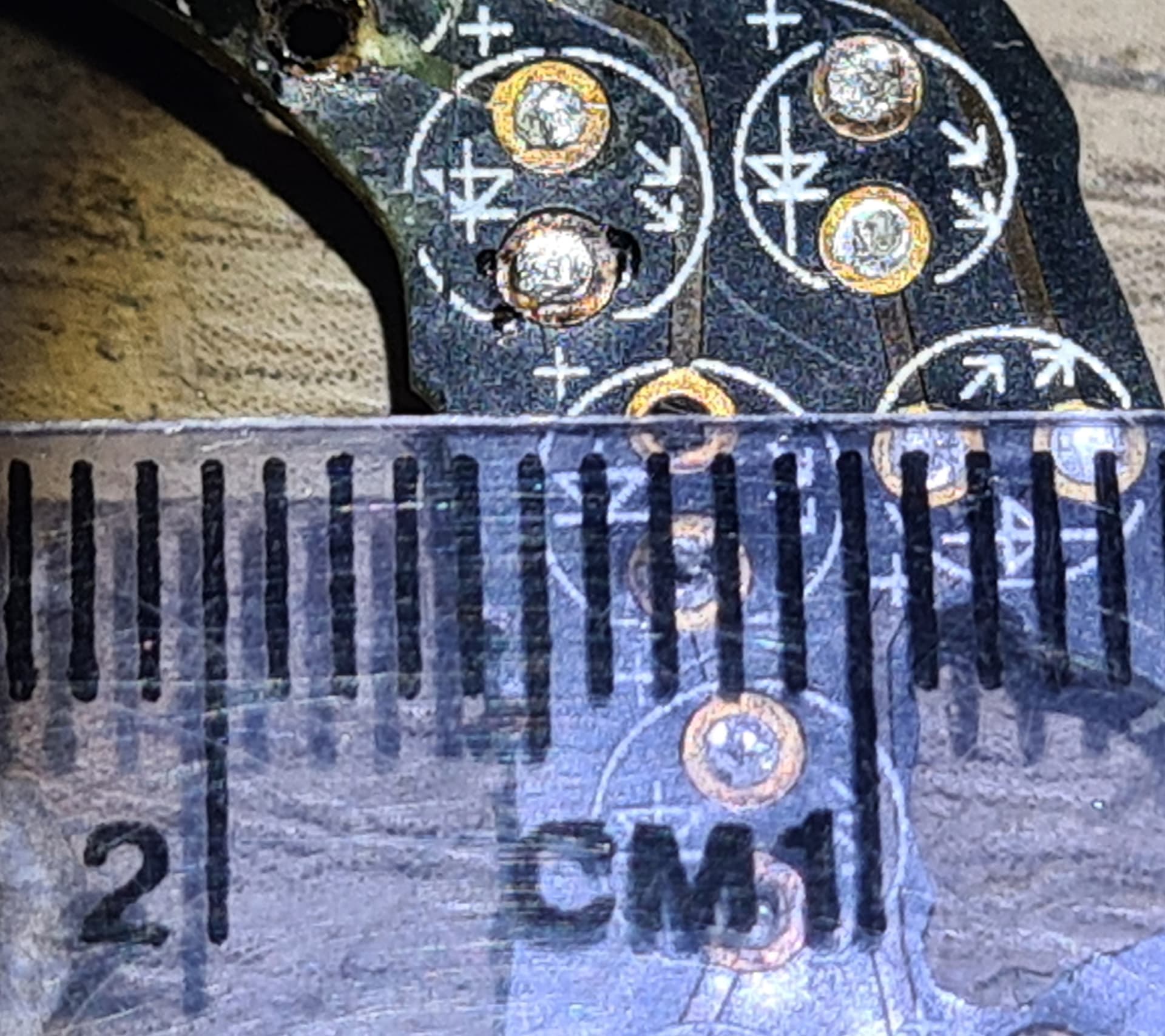

I have big problem. One of contact link (how you ever call it) is ripped out.
One part which exist I flipped it with a microscope (picture 4). But missing link around pin.
Would be that ok, or I need to throw the board in the garbage?
When I will solder new diode, would be spread on that link which I flipped and make contact?
Is the PCB board have only that links or they have internally "hidden" contact too?
This is how looks normal contacts:
