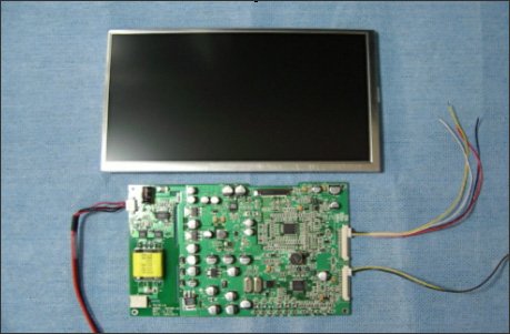

Hmm I need something smaller than that as I want to insert the LCD (view finder) into the camera case I am building. Don't want it to be too bulky. Should be about yey thin = http://i00.i.aliimg.com/photo/v0/218037684/TFT_LCD_Module.jpg

Your picture looks like a car seat-back LCD monitor, with CFL backlight (?).
That's quite a big display and controller board - are you sure it doesn't have a composite input?
