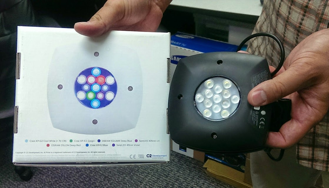

Hey guys... Ok so far I appreciate all the input. Forgive me for being new at this. Basically my main reef light is a 48" programmable wifi light made by a company called LedZeal and the model is the Malibu S...
What i'm trying to do is make a smaller light. Something that looks like an AI Prime for example (if you google you will see)
The chinese boxes use big bulky LED's whereas the prime uses these tiny diodes that make it super compact. I was hoping to get like a 15-20 LED design and controlling them from a controller.

That won't cut it here. I need high power LEDs. If you look at something like this:
So as you can see this AI Prime is using 13 LEDs and consuming 55 watts meaning these LEDs are consuming 4.2V at full power each.
