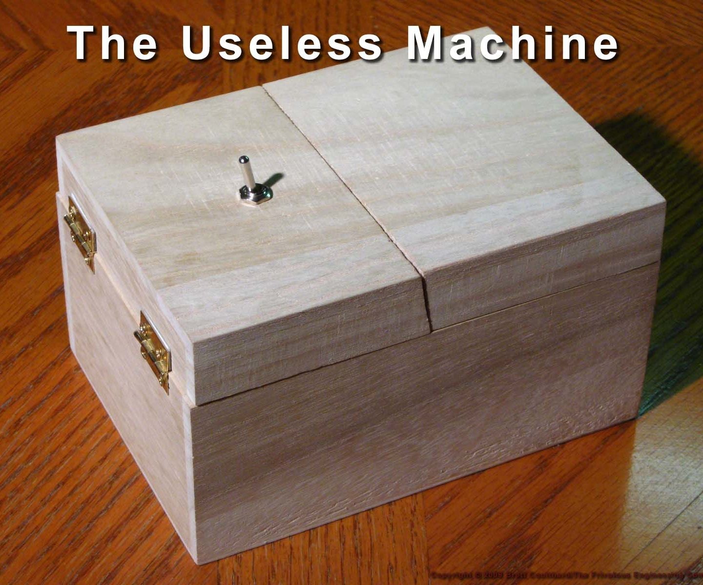

So, basically, you are trying to make one of these:
just with an Arduino instead of a 555 timer chip. :-/
Is the one you want to make more elaborate than that? If not, you don't really need more than one servo. The arm on those opens the lid.
http://www.instructables.com/id/The-Most-Useless-Machine/?ALLSTEPS
Huh
just with an Arduino instead of a 555 timer chip. Undecided

I am tying to make a box like this but more elaborate, with a better quality of movement: slowly and smoothy.
I would like to decompose movements to personify the puppet. I have already worked about.
But the challenge is to command two movements at the same time.
