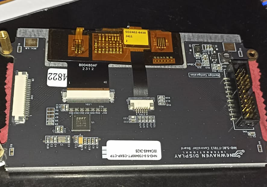

The advanced graphics controller is installed on the screen PCB, at first I thought that everything was done by the shield, but that is not the case.
Not so, that shield is an interface formatted for the arduino UNO, which allows the conversion of signals from 5V to 3V3; It has a microSD reader. In addition, it has a 20-pin header to which the TFT flat cable signals are directed and a two-pin adapter to connect the speaker.
I got a 5" NHD TFT with the FT813 controller.
This chip is present in the gameduino 2, 3 and 3x, as well as the shield sunflower, these variants I have not been able to obtain currently.
Several manufacturers such as Riverdi, New Haven Display, Matrix Orbital, Cristalfontz and brtchip have among their TFT lines, variants of the FT81x and BT81x chips, but they are not cheap at all.
I have worked for several years on the library called GDSTx, based on the gameduino 23X library, which can work with the SDIO reader of the teensy 4/4.1/3.5/3.6 boards using Greiman's most recent SdFat library.
But the milestone of making it work with an Arduino UNO has slipped out of my hands.
