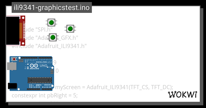

I used your sketch to create one that might give you some hints; it may not work with yur setup as you quite likely use a different display, but the principle should be the same.
You will have to adapt it to your hardware:
#include "SPI.h"
#include "Adafruit_GFX.h"

Feel free to check it out on Wokwi:
and of course insert your routines to store to and read from EEPROM ...
Buttons in accordance with their names "Up", "Down" and "Right".
To ease the sketch I removed the "bounce" function from the buttons ... Debouncing is probably inside your "joyButtonRead" function (I hope)

I really like the example you gave me, based on the Wokwi, @ec2021 . I will need to study it some more before I'm comfortable with things like
boolean getInput(String txt, int x, int y, int &data, int maxValue)
It just looks intimidating with the ammount of variables I have to wrap my head around.
and
static unsigned long lastPrint = 0;
why is it static? what does unsigned even mean? I think I am about to find out with the help of my friend Google :slight_smile:
