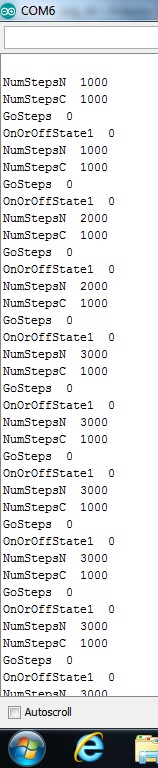

Hi Arduino community,
I’m working on the sketch posted below. I used the following integers and I was hoping that the integer GoSteps would return a value that i can use to drive a stepper motor a certain amount of steps.
int NumStepsC
int NumStepsN
int GoSteps = NumStepsN+(-NumStepsC);
As you can see ,in the printscreen from the serial monitor, this is not working. It would be much appreciated if someone could point out what i’m doing wrong.

No, GoSteps is not a macro.
You can place that line in loop() before you start printing and it will work.
The value held in a variable is not updated unless you specifically do it
int GoSteps = NumStepsN + (-NumStepsC);Declares and initialises the global GoSteps variable but subsequently changing the value of NumStepsN or NumStepsC will not change the value of GoSteps.
when you define a variable through a formula that's a one-off. it's not evaluated every time you call that variable. if you want to re-evalutate the formula you need to tell the compiler to do it

sterretje:
Yes that did the trick!
UKHeliBob:
This was the reason my sketch wasn't working! Updating GoSteps,NumStepsC and NumStepsN at the end of the loop turned out to be the solution.

makes perfect sense now. Excellent explanation!
