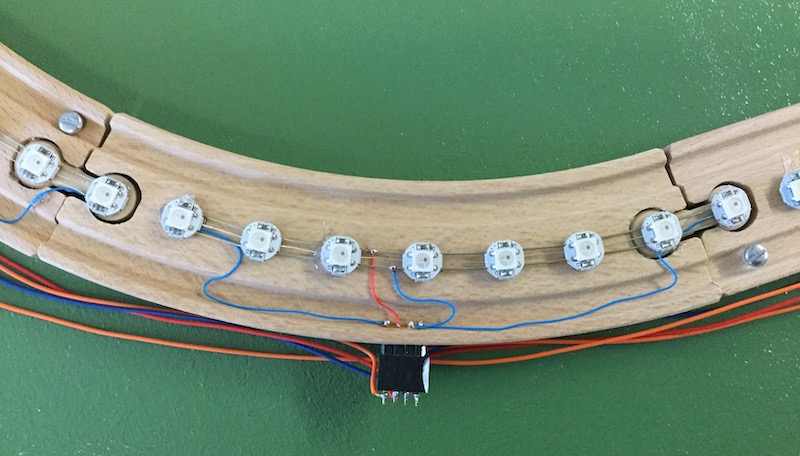

I used the type 1 to make a virtual train racing game covering the tracks with the LEDs
Project video at
This is cool. I think WS2812 might be a good choice to implement the matrix of LEDs. How many pins did you need to use to control all these LEDs?

One pin to rule them all.
Correct
Oh! I didn't expect you to use only one pin for all of them. Did you need to tweak something or this is just how addressable LEDs are capable of doing?
Correct.
see
