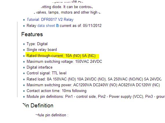

Do you know what is the maximum current rating of the relay for 12V DC? I am not sure reading the datasheet.
I am trying to turn lock and unlocked this solenoid door:
@lefty..... what might it be about that relay that would cause it to have different current ratings on the NO vs NC connections?
And is that a common thing in relays in general?
JimboZA:
@lefty..... what might it be about that relay that would cause it to have different current ratings on the NO vs NC connections?And is that a common thing in relays in general?
You know I saw that rating and was somewhat surprised as I've never seen that kind of rating ever before. I have seen a given relay have lower current rating for switching DC then AC on the same physical relay as breaking AC current gets the benefits of the AC voltage doing zero crossings, where as DC always creates higher arcing on the contacts for the same current value. So maybe a datasheet error really meaning 10 amps max if AC or 5 amps if DC? Either way one should most likely limit DC current switching to 5 amps max for that relay unless better information is forthcoming from the manufacture.

JimboZA:
It's not uncommon, especially in the world of automotive relays. The standard Bosch/Tyco relay can carry 40A on the NO and 30A on the NC. In general the idea is that the NO item is the high power contact you want to switch on and off. So in general if there is a rating difference the NO is usually the higher of the two.
