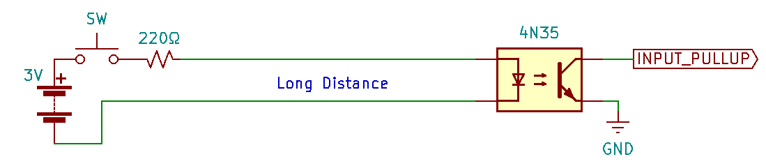

thanks for the confirmation, each line will be with two buttons one for maintenance ad one quality alert , i will have to connect 7 lines to one Arduino board that is 14 switches connected to the Arduino 15 meters apart. i am hoping there wont be issues with current and resistance of the wires
Current and resistance will not be a problem over 15m, interference might be.
Make sure you use twisted pair cable, for example cat 5 or telephone cable. Make sure each switch is on its own pair, do not spilt a pair up.

The best approach is likely optical-isolation... essentially a LED with a phototransistor in a single housing. By setting a digital pin with internal pullup, the phototransistor easily pulls the "high" pin "low". The LED section of the isolator is also very forgiving of electrically introduced wiring noise.

That doesn't really solve anything. There's no real isolation, since they're already using a common ground and in post #3 I told OP to use a 100ohm pullup on the input.

I found only this opto isolator "pc817" . I am thinking if I use a 12v 5A power supply running through the switches and the turning on the Optocoupler which in turn signals the Arduino.
And I was looking on the data sheet for the Optocoupler and its say input current maximum of 60ma any idea on choosing the right value of resistor so that I won't fry the Optocoupler
Correct
Any idea on how to use pc817 Optocoupler with a 12v5A power supply in the led side
Ohm's Law: E = I * R
one little twist, E is the supply voltage - LED voltage drop
(remember, calculate a current under max)
Vd of LEDs is color dependent, but I use red for optocouplers unless you have a detailed spec sheet... about 2 Volts.
