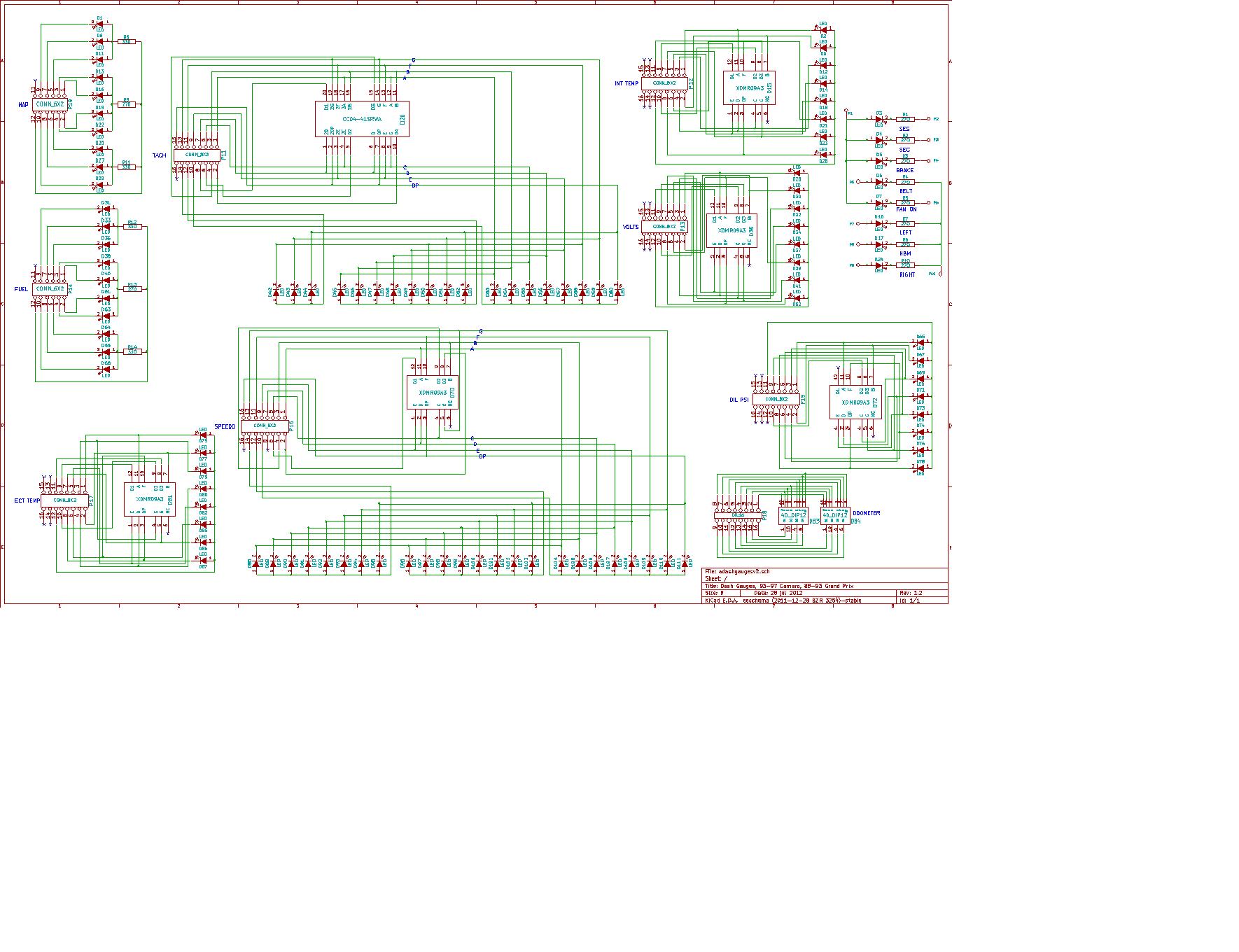

I'm attaching the schematics for the 2 boards... The pinouts on the connectors that run between the boards are identical, pin 1 to 1, pin 12/16 to 12/16, etc.
How about a larger version of the second schematic?
Rob
I'll get another version of the gauge schematic shortly. I will need to completely start over with a new file from KiCAD before I resize it. I didn't think it ended up as small as it did.

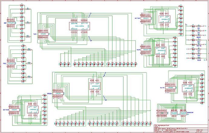

Resized gauge schematic... Don't mind the indicators in the top right... Those are wired specific to the car's harness and are completely independent of the Arduino.
