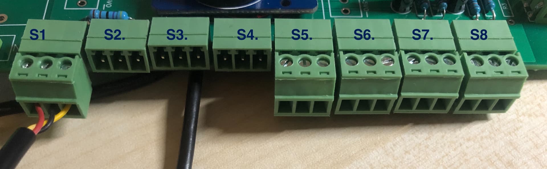

I am reading temperature from 8 DS18b20 sensors by one wire bus, and I can get all reading very well without any problem.
I also record the address of each one to keep them running in the correct sequence. When I replaced one of them due to damage, the whole sequence was changed, and I had to rewrite the code and re-upload it. Is there any way the sequence, despite changing the code or using individual GPIO for each wire?
 ![ds18b20_arduino_multiple](https://europe1.discourse-cdn.com/arduino/original/4X/6/3/7/637a382732c4ee990f1decfcdaa8a3b595f9bf8d.jpeg)
 ![IMG_8813](https://europe1.discourse-cdn.com/arduino/original/4X/8/d/4/8d40d6301cea4b5cc2471f147d2d365f80cd6640.jpeg)

It would appear that you are using the "by index" method, but you still have to edit the programme if you get the data by address. I think the only way out is to have a large stockpile of spares and a lot of luck, thereby enabling you to put a replacement in in the proper sequence.

You can store the sensor addresses in EEPROM, in the order they are physically situated. At startup, check all the addresses are reachable, also check for any new ones. If one is gone and a new one has appeared, that's a simple fix.
If several are gone though, you would need a more fancy interface for the user to indicate which is which.

Thank you so much @johnwasser. That was helpful. In case one of these sensors got damaged and needs to be replaced with a new one, will that make any difference?
