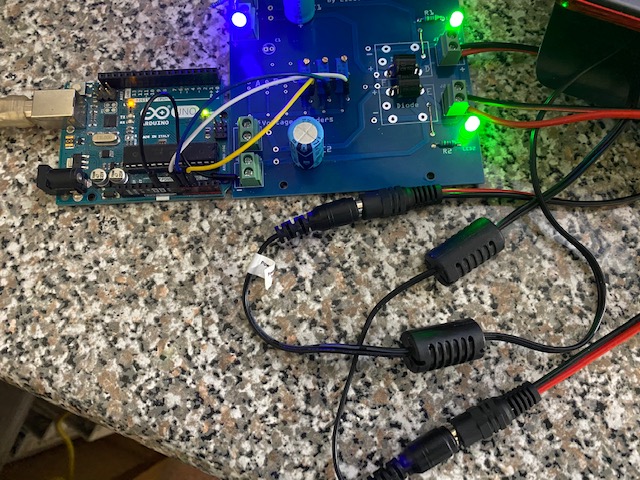

Wiring diagram please.
JCA34F:
Well, I would but can't as it wants a URL.

JCA34F:
Here is the link to a picture of the UPS-PCB that I designed and working on the Arduino code for. It has 2 inputs and 4 outputs. I will be enhancing the Arduino's code to send me a text message/email when either (or both) the Battery/Solar power source or the 110VAC to 12VDC power supply inputs drop below a specified voltage or goes above a specified voltage. It also monitors the voltage on the load side of the 30 amp Blocking Diodes. The blocking diodes allow for the use of 2 different power sources without an interruption to power. They keep the input power from reaching the other power source. The green LED's on the right show which input has power, the blue LED on the left just shows that there is power on the load side. It has the capabilities of 6 voltage dividers of which 3 (in the picture) are designed into the PCB and connected to the 2 inputs and blocking diode outputs. The 2 blue 470mf electrolytic capacitors absorb any voltage fluctuations, should one of the power sources drop off.
This UPS-PCB is designed to keep all my Home Automation and Energy Management equipment up and running during the MANY power outages here in Florida. Most of the time the power outages range from a few seconds to hours, constantly making the electronics reboot and sometimes need to be rebooted after the power failure as they did not come back on line working properly. It also allows keeping the Energy management equipment up and running monitoring the power companies power outage.
My website link
Picture of the UPS-PCB circuit board.

int VoltageSource_1 = analogRead(A1);
Reading A2 once here, but doing nothing with VoltageSource_2 ever...
int VoltageSource_2 = analogRead(A2);
Using a multiplier of 1.6 for A0, but then 1.61 for A1 and A2?
Nothing wrong with your "while" loops now, but they are a somewhat blunt instrument for doing a loop a set number of times.
Usually that is the job of "for"...

Thank you!
Originally I was using those variables and decided to use different names and needless to say, I forgot to remove the old ones. Need to do a little better cleanup of code.
I will give the "for" method a try to see how that goes.
I must have truncated the last number in the 1.61 in the equation when copying it to the others
...Corrected.
The voltages are more constant now with the averaging
Again thanks to everyone
Thanks again, working perfectly. Here is the latest code. Will try using the "for" tonight.
