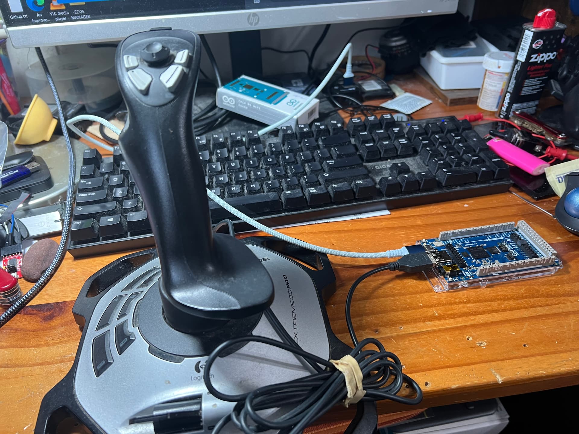

Decided to do more debugging of the gamepad sketch. Started comparing the output from Teensy USBHost and the GIGA USBHost to see whats going on. Using the same PS4 attached to both:
Device Descriptor - Matches:
**Teensy**
Device Descriptor:
  *12 01 00 02 00 00 00 40 4C 05 C4 05 00 01 01 02 00 01*
    VendorID = 054C, ProductID = 05C4, Version = 0100
    Class/Subclass/Protocol = 0 / 0 / 0
    Number of Configurations = 1

Am I crazy or is it not getting additional endpoints? EDIT: looks like it only picking up endpoint 84
EDIT: Think this might go along with what @KurtE mentioning in the previous post

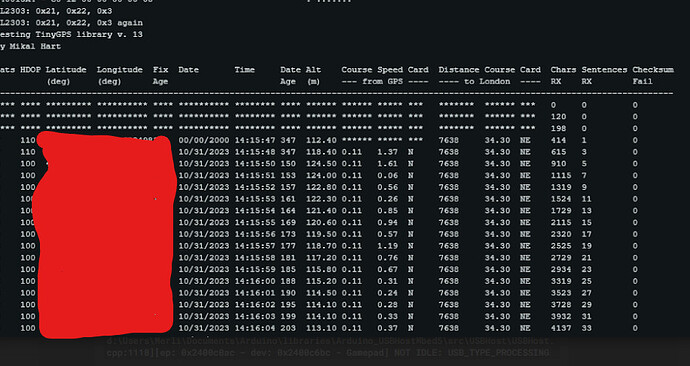

Maybe making progress on getting the GPS to work... Maybe...
I am trying now to do the extra steps once the initial connect code finishes, to do the PL2303 specific initialization to be done...
And theirs is a PIA!
First here is a capture of the USB traffic that I captured on Teensy Micromod using @Merlin513 sketch from back when... This is from my extended Saleae USB analyzer, plus an HLA to filter the data to setup and IN and OUT messages:

And here is my output on the GIGA board. I think my reformatting of the setup messages may be off from the format used in this library.
Will look more later.

Found the issue, in the message used to set the Baud/format, my editing had 20 instead of 0x20
USBHost_FTDI_plus-231030a.zip (5.8 KB)
I am not doing anything with the data yet...
SBHostFTDI::rxHandler() called240012EC - 24                                                : $

Next add it to a Serial RX queue. Not sure if I will use the one part of the ArduinoHost-API code, which is not safe... Or the hacked up version I did for UNO R4..
I also forgot how stupid these devices are... You talk at baud of 4800 and they send only 1 or 2 characters per USB packet... But at least they are talking :smiley:
Quick update, I hacked in the rxBuffer code and @Merlin513 earlier code for GPS and...
So that part is working...
Now to add in txBuffer support, and then try with other adapters.

Been spending the last few days playing with my gamepad sketch.
For a Genuine PS4 and a Voyee clone was able to connect no problem and retrieve data. Also did several additional functions to make it look more like the joystick code we used on the Teensy. This includes rumble and setting the leds.

Unfortunately the other 2 PS4 Clones both behave slightly differently.
For the Teiros controller it connects but no data is returned:
VID: 0x54C, PID: 0x5C4
Match PID/VID:
GamepadController:: gamepadType_=2
(parseInterface) NB: 0, Class: 0x3, Subclass: 0x0, Protocol: 0x0
	After get end points
New Gamepad device: VID:054c PID:05c4 [dev: 0x2400c8f4 - intf: 0]Dev connected
Joystick connected
With the teiros looking that the debug data it does try to read it but keeps giving me CONTROL READ SUCCESS [0 bytes transferred]
For the other PS4 clone controller it will not connect:
VID: 0x54C, PID: 0x9CC
Match PID/VID:
No gamepad connected
Did try an Xbox controller and same think will not connect so can not go further with that device.

The Serial object appears to be working on several different devices including:
Arduino UNO R4 MINIMA, Teensy 3.x, Teensy 4.x (although only at Full Speed), FTDI, CP2104, CH321. The PL2303 code appears to have some issues... Will debug again soon.
The main example that copies stuff from USB to the USB Host and back was updated, to now detect when the device goes away and then detects if a new one is plugged in. Likewise it detects if the Serial object changes baud rate and then tries to restart the plugged in device at that baud rate.

Did a diversion from gamepads and hooked up a Logitech Extreme 3d Pro joystick: Amazon.com: Logitech G Extreme 3D Pro USB Joystick for Windows - Black/Silver : Electronics
and managed to get it working.
Starting gamepad test...
Match PID/VID:
New Gamepad device: VID:046d PID:c215 [dev: 0x2400cb0c - intf: 0]Match PID/VID:
Joystick connected:
Manufacturer: Logitech
Product: Logitech Extreme 3D
rx: 8, ry: 114, rz: 127, hat: 8
Slider: 161, ButtonsA: 21, ButtonsB: 0
Button Map: 1, 0, 0, 0, 0, 1, 0, 0, 0, 0, 0, 0,
rx: 20, ry: 114, rz: 127, hat: 8
rx: 252, ry: 81, rz: 127, hat: 8
rx: 11, ry: 2, rz: 127, hat: 8
Slider: 163, ButtonsA: 21, ButtonsB: 0
rx: 0, ry: 2, rz: 127, hat: 8
rx: 28, ry: 2, rz: 127, hat: 8
rx: 100, ry: 242, rz: 127, hat: 8
rx: 8, ry: 242, rz: 127, hat: 8
rx: 0, ry: 242, rz: 131, hat: 8
The joystick has 12 buttons in 2 groups (ButtonsA and ButtonsB) with a little coding broke it out so all 12 buttons can be tracked individually. Button Map shows a couple different buttons being pressed.
