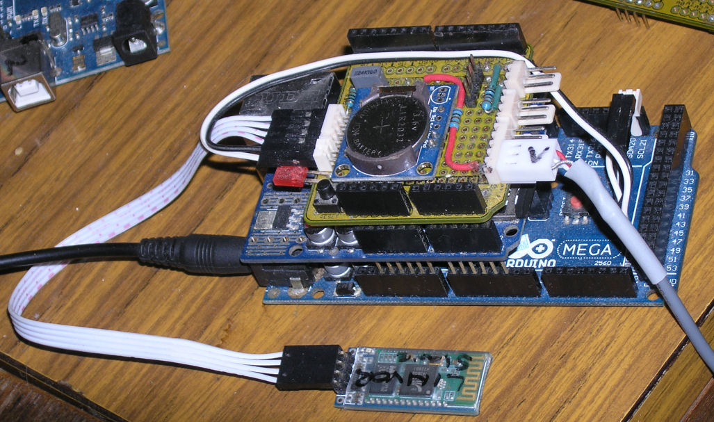

When it comes to peripheral items, you are not likely to get what you want with a store bought shield, but there is a swag of prototyping boards available to make your own. There is no obligations to use a shield per se anyway. If you have a lot of connections, it may be more convenient to have a separate board of any size that run ribbon cables to a proto board that is simply being used as a multi-connector

Yes. You can make whatever you need. Most of mine consist of - 3x headers for temp sensors, 1 x water flow, on-board clock, headers for bluetooth and and I2C LCD. No amount of money will see you with a store-bought that can do that.
