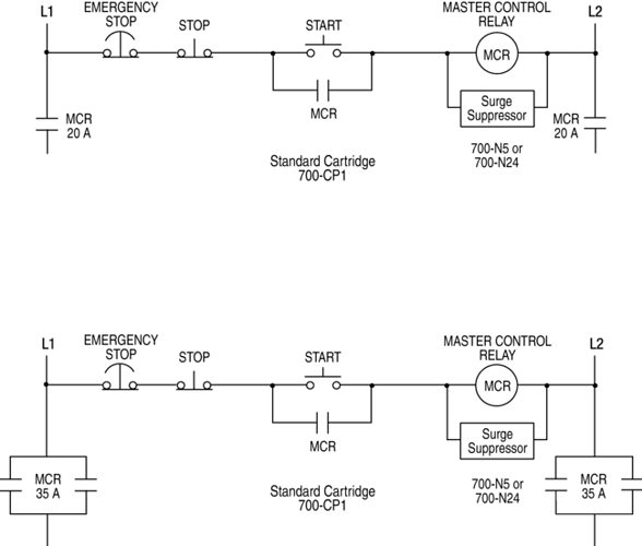

Can someone tell me what this schematic symbol is?
Trying to help someone out with a schematic. Came across this symbol and don't know what it is. Couldn't find it online when I searched. It's in a vehicle (of sorts) :wink:
Thanks in advance!

It looks like a diode installed across an inductive load. Maybe a small motor or a solenoid???

Yah, looks like an inductive load with a diode across it (opposite the direction the power is normally applied) so when the load is shut off, the you don't get a voltage spike.

What it is, is a non-standard symbol meaningful only in the context of the document in which it was found.

Showing what it is atatched to may give further clues.
I think I see a "K" under it. That is often a relay designator.

Not entirely true. In the Industrial World, it is a standard symbol for a relay, especially with the designator "K" or CR (control relay). A solenoid is a different symbol. Many industrial relays will have the suppression diode built-in which is why it's shown that way.

"A vehicle of sorts", can you post another picture showing the circuitry around it.
What vehicle, make etc, country of origin will help.
But I would say its a coil/solenoid or a motor that only needs to run in one direction.
The figure 86 beside the item, definitely a relay, standard terminal coding.
