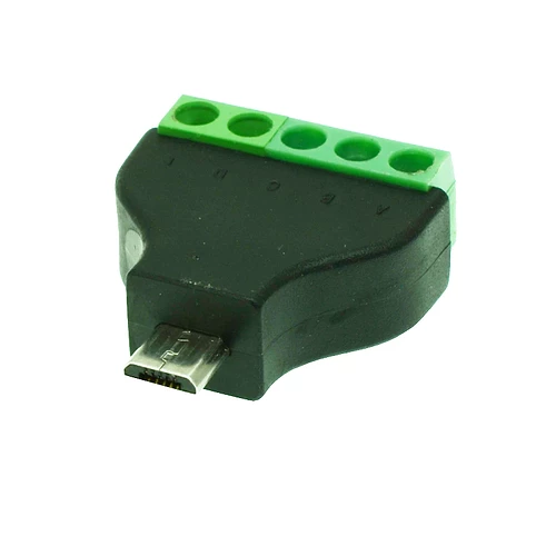

So it's possible, just not recommended. The project will be enclosed within a box, so I think it will be safe, but I guess the best option would be to power it through a micro usb like this one.
Or just hack a cable and bring out the red and black wires.
