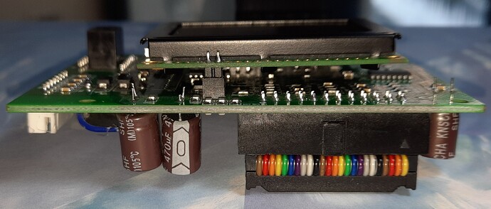

I´m wondering if is possible control this LDC Screen with arduino, is a lcm12864I 128 x 64 pixels, I´ve a lot of this and want make is useful in any arduino project, also it comes with board, don´t know if the board can make the connection easy because I´ve looking for datasheets and saw a IC on board as LCD controller, not sure how connect, that´s why publish this topic in order to receive some information or help to give well use to those LCD´s.
This is the LCD board.
This is LCD back view.
Board View 1
Board View 2
Board Proccessor Unit view.
Group View

I would put money on it being a KS0108-style display.
However it is possible that it is a ST7920.
Or even a Toshiba T6963C.
Googling "LCD12864i" gets https://www.mybotic.com.my/products/LCM12864I-LCD-Display/2404
Of course it would be much easier if that link had a photo of the pcb.
